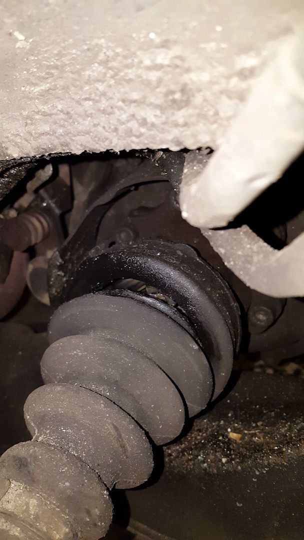

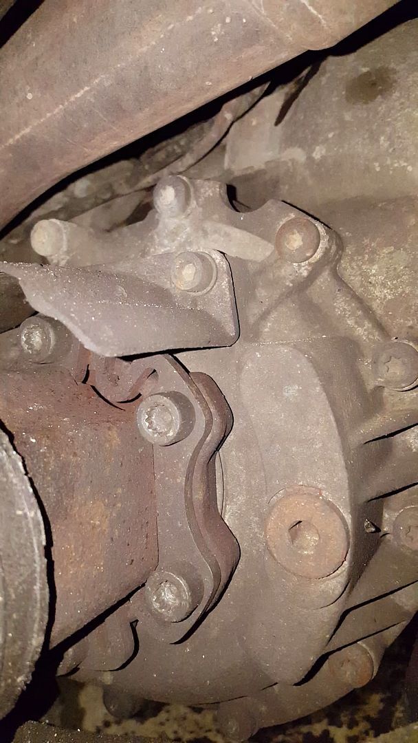

    I noticed the inside of my o/s/f wheel was getting grubby so i decided to take a look and as suspected, the inner CV boot had split. Whilst checking the inner CV joint for free play i found there was quite alot of movement in the driveshaft. At first i thought it was just the CV joint, but then found that the whole gearbox flange was moving!! the CV joint seems tight to the shaft, and tight to the gearbox flange, but all the movement is coming from what i believe to be the diff bearing. The other side is nice and tight and firm with no free play as you'd expect.
    The strange thing is whilst driving there is no symptoms of this at all, no whining, no noises, no clonks, the drive train is seamless, its not even leaking oil from the diff seal. I have only discovered this whilst looking at the CV boot.

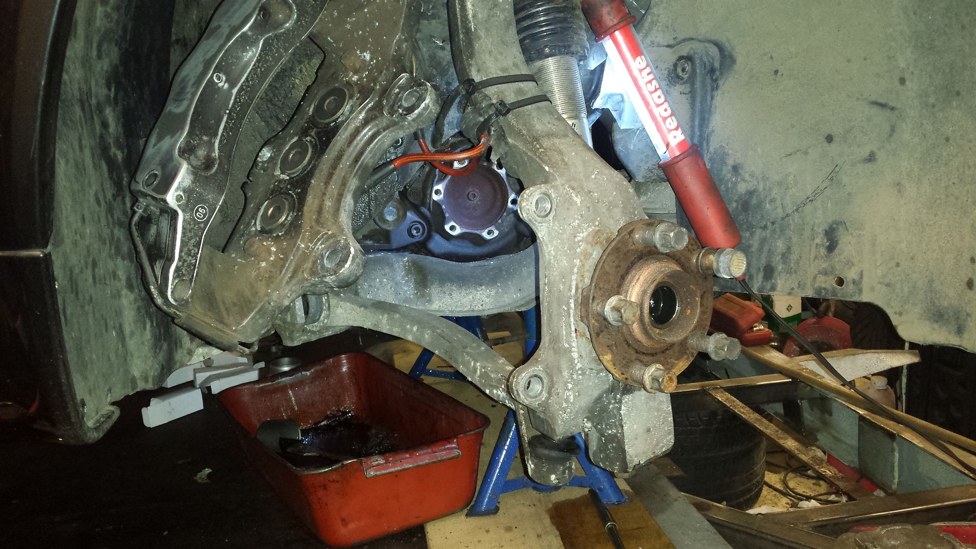

    i found an old picture from when i had to renew the outer CV boot, so it does show there is a bolt in the centre i can check initially to see if that's still tight

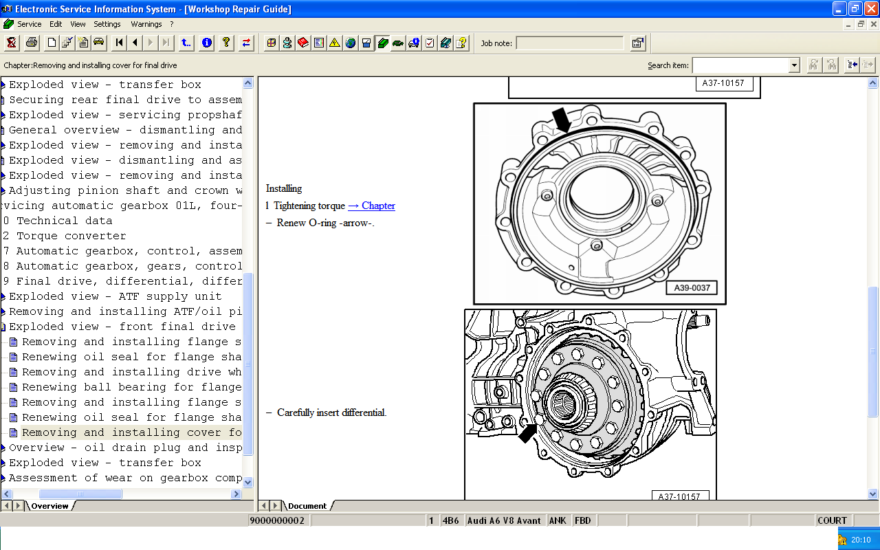

    I've had a read up on ElsaWin and it shows if you remove the driveshaft flange and the 12 bolts around the 'final drive cover' you have full access to the diff (and it will just fall out). Is this the not available bearing you mean?

    nice calipers. brembo 18z by chance ?
    yes (that last pic was just before i painted them)

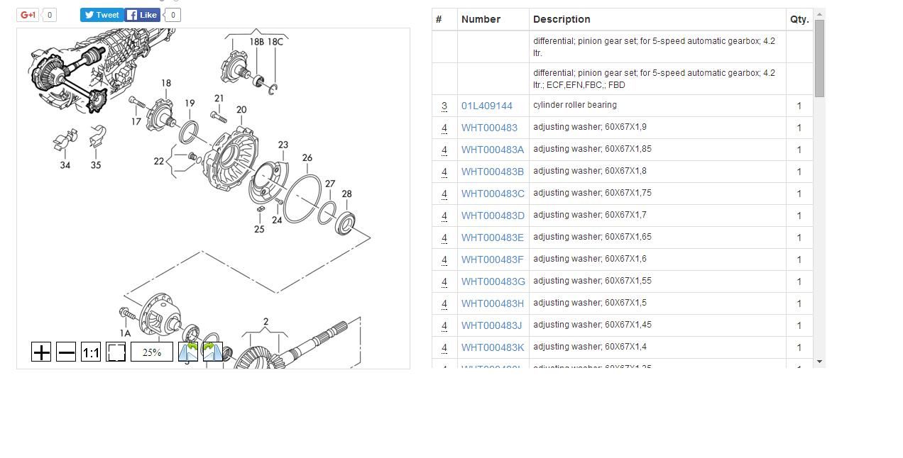

    The needle bearing item 18B in the exploded parts diagram ?
