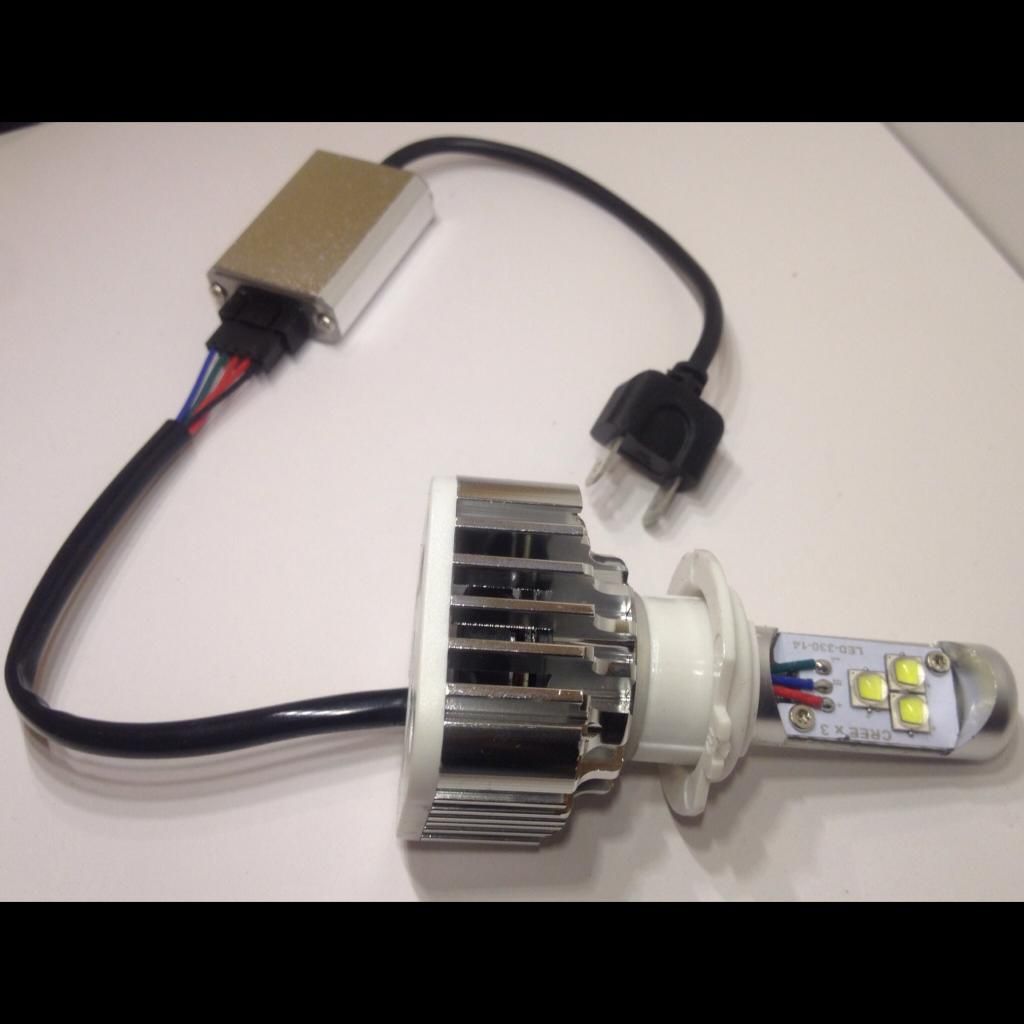

    Osram Night Breaker Unlimited + 110 % and Philips X-treme Vision + 130 % are the two top halogen bulbs .
    But they would be outperformed by Cree LED .
