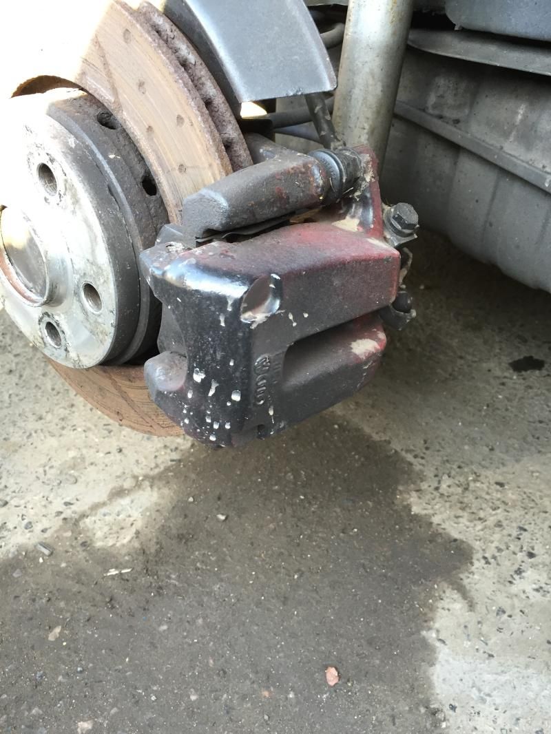

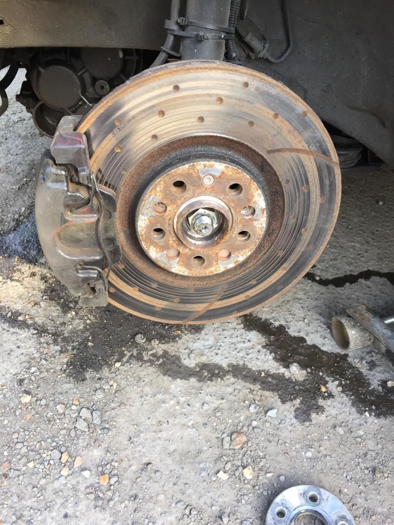

    Anyone know what brakes these are
    look bigger then standard on a mk4 pd130

    you need to measure the diameter of the disc.

    Fronts look like a Teves calliper as Zollaf says you need to measure them

    Simple's, Golf 4 Anni petrol/Golf 4 V6 4M/Octavia 1 VRS 312 front and 256 vented rear. Standard conversion I have been doing on the PQ34 platform since 2003,
    One the back of my shed, new discs and calipers in the CORRECT green.....
    This was the first one I did in 2004 on an almost new GTI TDI 150, we fitted the red genuine new calipers before you could buy them from TRW directly.
    You can buy them in green and blue as well but not the carriers so I had the correct shade of green mixed and painted the carriers and gave the calipers an extra coat, or three.......

    Thanks crashed pretty sure they are one of the ones you mentioned. Will measure and expect to see 312/256mm
