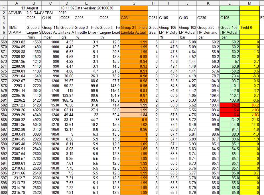

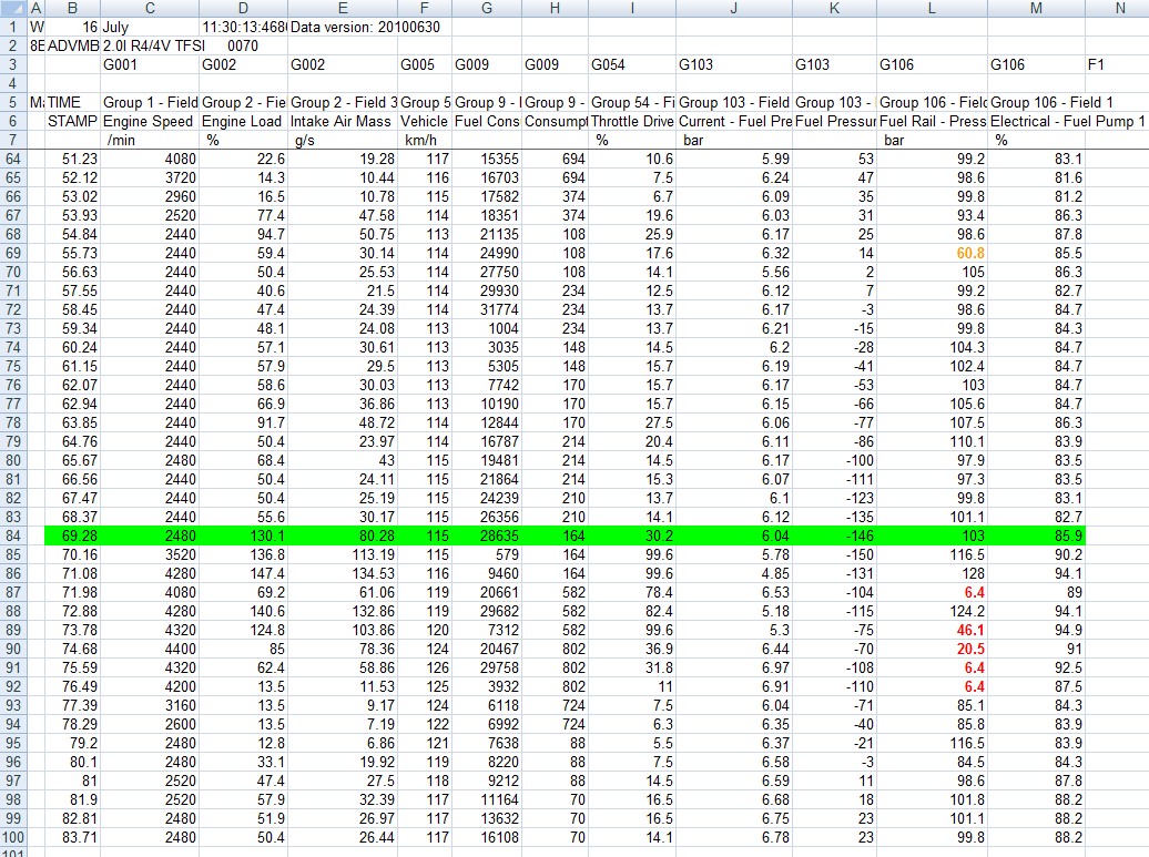

    Below is a VCDS log from before the LP filter and pump change. Below that is a link to a longer log (.xls) after the LP fuel filter and in-tank pump change.You can see the HP pressure drops and corresponding values fro engine speed, LP pressure, throttle angle, LP pump, etc.
    To me it looks like the problem is on the HP side, i.e. the LP fuel readings seem fine but the HP readings drop from over 100bar down to single figures. Despite these logs, both the dealership and forum posters keep suggesting the LP side. I can see how a problem with the LP feed would affect the HP feed but if anything, the LP value is at its highest when the HP is failing...!!!

    After doing some additional research, I ran some more logs after adding in the lambda value. As you can see below, the lambda value suggests the power loss may be a direct result of genuine fuel starvation and not (as I wondered) as a result of the ECU killing power due to an erroneous (low) HP fuel sensor reading. The only other time you see such a lean reading is when the throttle is almost closed on overrun and no fuel is being thrown in. That said, the ECU is definitely reducing the throttle when compared to the actual pedal position (not in the log) so it may also shut off the injectors due to the low fuel pressure...? Who knows...? It's hard to draw a proper conclusion without a better working knowledge of the system.
    It's also worth mentioning, that the issue is intermittent and symptoms aren't necessarily consistent, i.e. the problem may or may not occur given seemingly identical circumstances. In addition, sometime the car jerks whereas other times it feels more like a limiter has been applied.

    Still limping along with this issue. I've scoured the forums and seen many suggestions for some of my symptoms. I've seen a few people change the LP fuel sensor (thrust sensor), which has sorted their problems. In my case though, it seems that the LP side isn't the problem, the HP side is.
    I've been wondering if the HP fuel sensor may be at fault? My thinking being that the apparent fuel cut is simply the engine going into "limp mode" upon detection of apparent low HP fuel reading?
    Alternatively, I'm wondering if the fuel pressure relief valve is cracking open and pushing all the fuel back to the LP rail, effectively robbing the injectors of the pressure they need and slightly raising the LP rail fuel pressure (as seen in the logs)?
