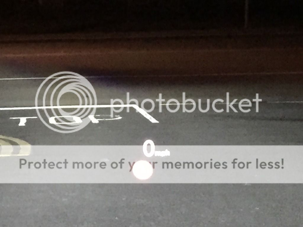

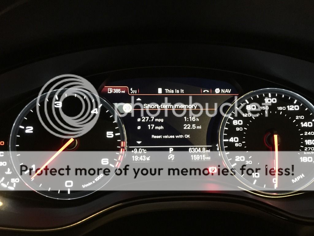

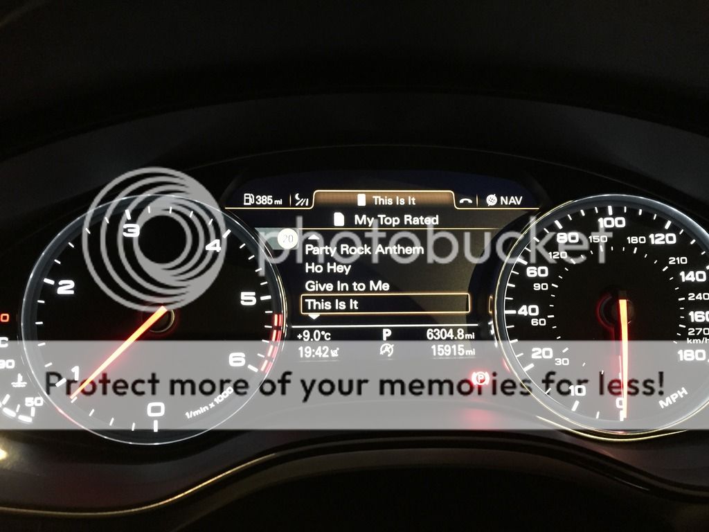

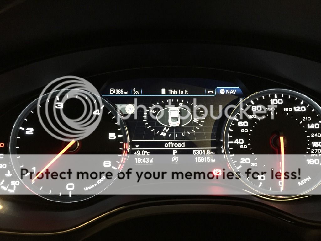

    It works on every screen in the DIS and the HUD. Not the best pics but looks great and really sharp in real life.
