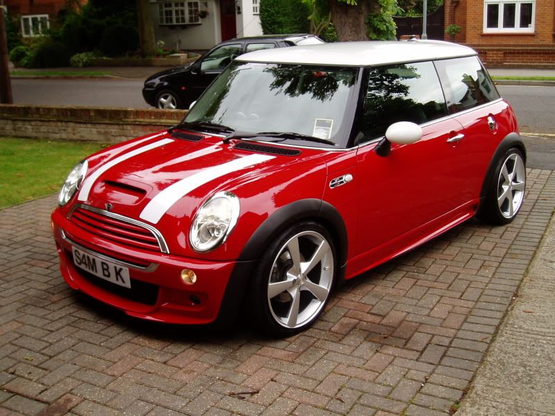

    It's always been my plan to get it close to 240/250 bhp.

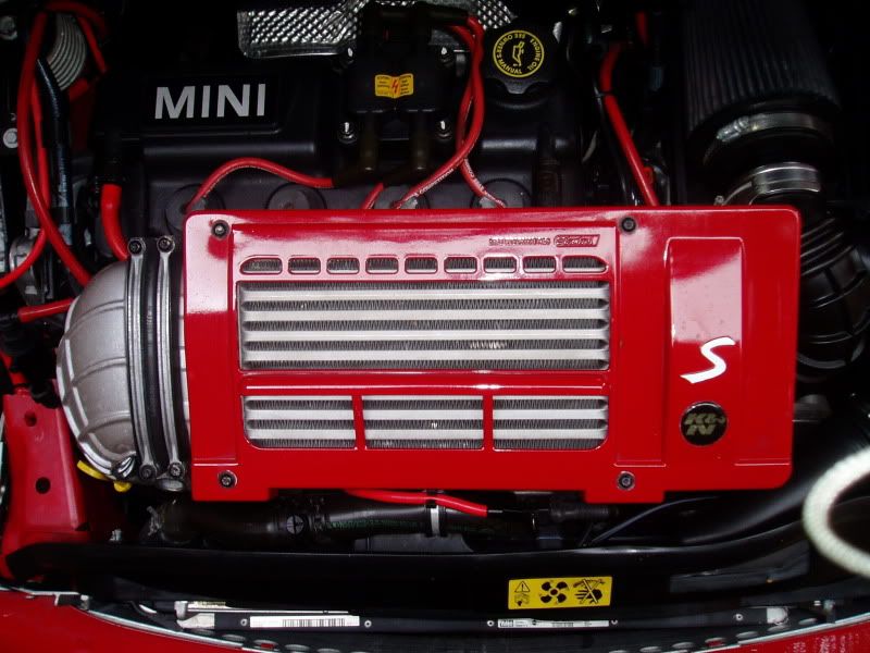

    My last Tuning experience was a 2002 Mini Cooper S, I took that to 250bhp and it was Awesome!!

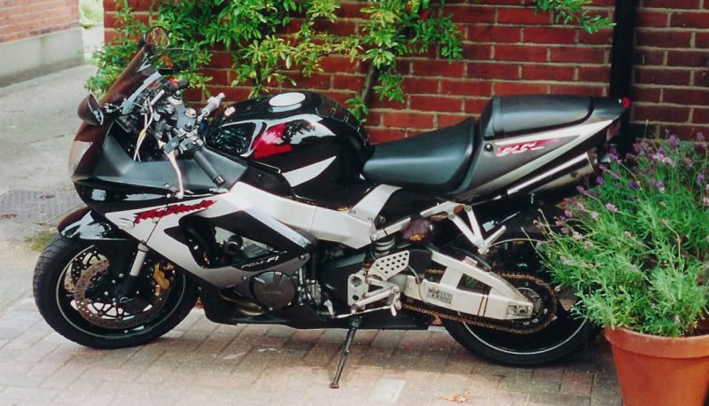

    Before that it was Motorbikes, and yes........you guessed it, they never stayed Standard!! my last bike was a Honda CBR Fireblade that i had 187mph out of in Spain

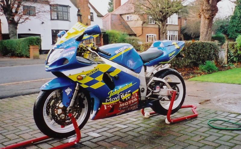

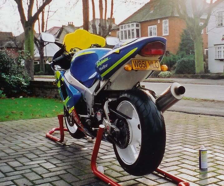

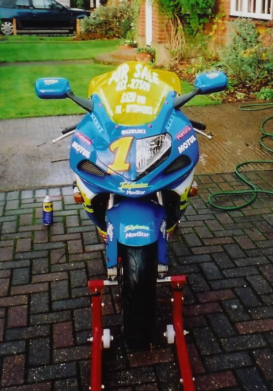

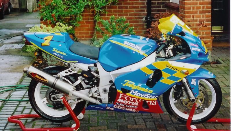

    Then i had this beast. this was awesome and put a smile on my face everytime i rode it! i spent over £3,500 on the paint job and engine mods.
