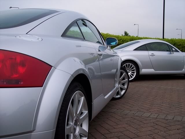

This was the first of two silver TTs on the back of each other. Looking very clean, this was my first silver car and I wondered how much of a difference could be possible compared to the mammoth renewal of the paint surface on my own ming blue A4.

As you will see from these final pics, the paintwork was left very glossy and wet with increased clarity in the reflections. I was very pleased with the results and the owner said it was way beyond his expectations. TOTAL MACHINING AND PROTECTION TIME: 12hrs.

The TT in the background would be the next car to be treated to two days of the same treatment.
