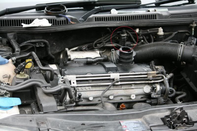

    Check the VAC line on the N18? I lost all boost (allbeit on a 1.9 tdi) and the N18 vac hose had popped off.

  7. Re: uh oh!! Where is the EGR under the hood? Found a fault.
    Feb 2008
    40
    Sorry, but that doesn't look anything like my hood inards!
    ill have a poke about in the meantime for any piping which may have popped off though.
