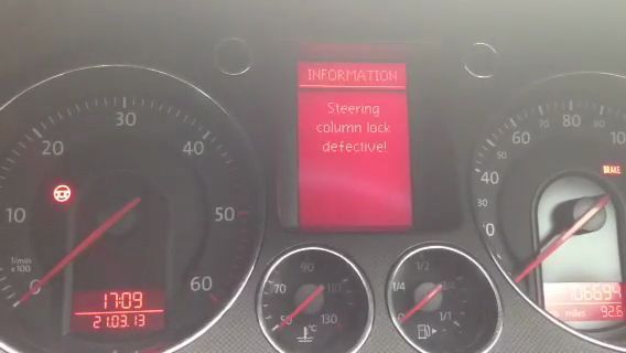

    I have a intermittent starting fault.
    Occasionally (once every week or so) when i go to start the car all the dash lights will just go crazy and start flashing oddly, some times it will start but then the glow plug light will start flashing and it will just cut out straight away. On the occasions that all the lights flash, i get different messages on the MFD display, sometimes "Immobiliser Active", sometimes "Steering Lock Fault" etc.
    Now if i just take the key out for a few minutes and then go back to it will be fine and no problems. Its been doing this for 6 months or so now, sometimes it can do it more often and others not doing it for over a month.
    Id like to get it sorted now though, anyone know what it is and how much its going to cost me?
    Heres a video i took today as i was waiting:

    I've had a problem once or twice the same as yours and took advice on this forum.
    The immobiliser active fault is actually different to the steering lock - it occurs if the key slot is having difficulty reading the key, so either faulty key or faulty key socket. This has happened to me twice in 4 months, but is hardly regular so I am not worrying about it.
    The steering lock fault is another matter. A great piece of advice I have had here is to be patient when starting the car. So let the yellow steering light go out, then let the red steering light go out before pushing the key in. If the mechanism is getting worn it may have difficulty keeping up with you slotting the key in quickly. The two times I have had the steering lock message and loud beeps have been when I've pushed the key in too fast.
    I've never had the flickering warning lights I see in your video, neither the 'move steering wheel' message, so yours may be near the end of its life.
    Because in my case this is not under a warranty, I'd prefer to take a few seconds less starting the car than spending the £350 at a dealer to have the steering lock altered. That is the cost you'll be looking at if it goes completely, so although unwelcome, not a massive cost.

    Will this fault eventually stop me from being able to start the car completely? Bit risky but if so could possibly wait and then use my AA parts and labour cover to cover the cost?

    It may eventually refuse to start completely. Most people give up before that point because the issure is driving them crazy.
