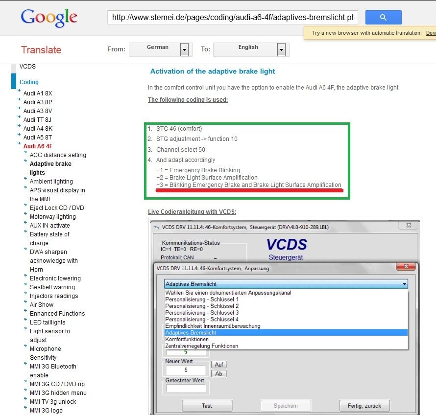

    Module 46
    Channel 50 coded to 0 = No hazard flash or brake flash
    Channel 50 coded to 1 = Only hazard flash... No brake flash
    Channel 50 coded to 2 = No hazard flash or brake flash
    Channel 50 coded to 3 = No hazard flash or brake flash
    I'm happy with hazard flash only ... will still be exploring the J519 (module 09 adaptations) for DRL project (that's me hoping I still have an A6 )...
    Channel 050: Adaptive Brake Light
    • +1 = Emergency Brake Blinking
    • +2 = Brake Light Surface Amplification (only Sedan)
    Note: Adaptation value is the sum of the individual options.
    So maybe it is a saloon only thing ... but then you would think if Avant in Europe it should also do brake flash ... maybe some diggin around on the European forums ...
    Quote Originally Posted by Brycie View Post
    I do think the hazards coming on is a great idea though, the way yours do at the minute. Shame they don't come on a little earlier than at standstill, but still, better than not coming on at all. Looks like I'll be busy on vcds this weekend.
    I can see why it as it virtually standstill as to save the confusion point...
    This was one of the best pages I found on another VAG car... Link:- How to turn on the emergency ABS brake light flashers on VW Golf Jetta Sportwagen enable
    I will now pester the ASN posters in the earlier linked thread as module 09 (J519) does not stop hazard flash on my car and the enquiring poster also seems as if he has an Avant and thread is newish?
    Link:- Turn off hazzard flash when braking hard
    *** Update ***
    Google translated link:- http://translate.google.co.uk/transl...ed=0CGMQ7gEwBg
    Non translated link:- http://www.stemei.de/pages/coding/au...bremslicht.php

    I think that bit 0 is enabled by default in Germany. **********************
    STG 46 - Comfort System
    STG coding -> Long Coding Helper -> Byte 8
    Bit 0 - Emergency Brake Flashing via Turn Lights active (1 = active)
    Bit 1 - Emergency Brake Flashing via Brake Lights active (1 = active)
    But it must be an emergency - a hard braking does not work.
    The effect of my LEDs are enormous - in an emergency stop, the brake lights flash to a stop, and a few seconds later.
    Above is from Link:- Warnblinkanlage und adaptives Bremslicht Seite 2 : Ist es eigentlich erlaubt? Auch versicherungstechnisch?
    So in the A5 it seems a selection can be made ie Bit 0 = indicators Bit 1 = brake lights... they also discuss the legaility of brake flash in Europe in that thread...
    Maybe there is more to coding the 4F without long coding/helper,etc or the same thing but in different format ...
