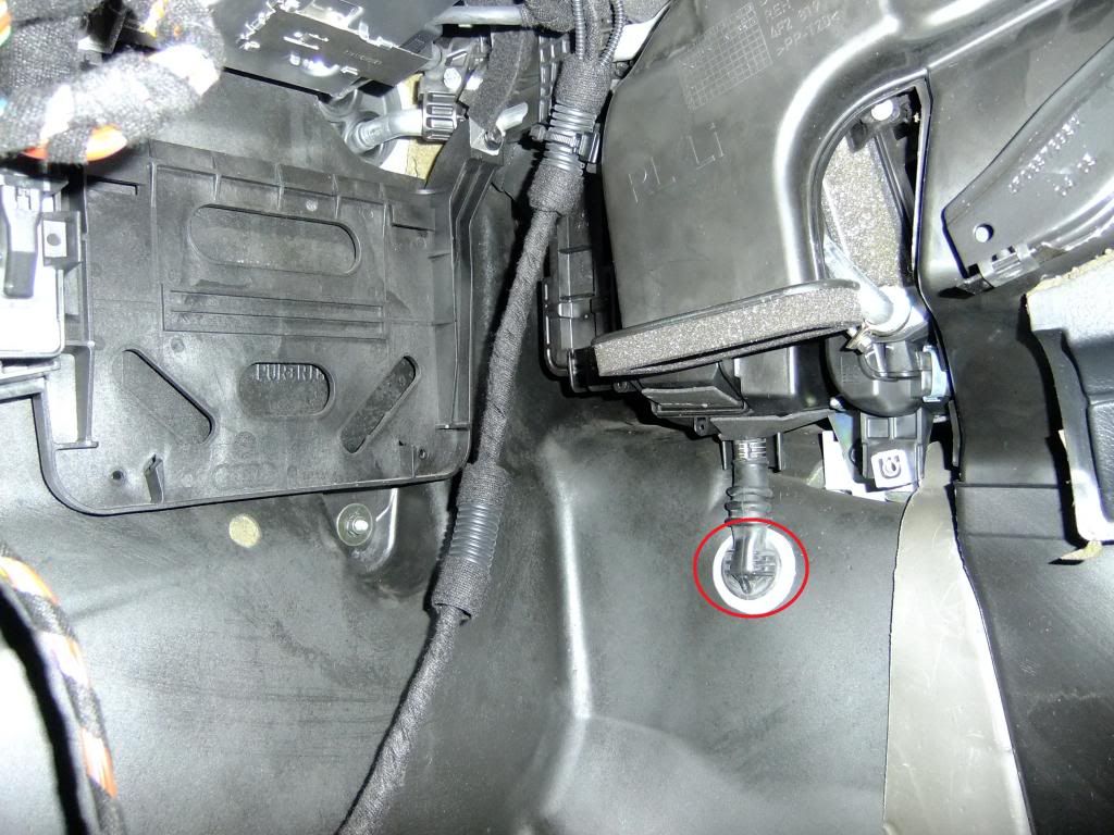

    One more question (just incase, the water inside my car very clean) where's the A/C condensate drain(s)?
    Cheers
    Dave
    You'll find them behind the gearbox tunnel side trim... IIRC you may need to remove glovebox/lower dash trim drivers side as well... there are two drains either side of the tunnel...
    If the carpet near those points is dry then you will have the floor water seep... unless its coming in through the plenum elec.boxes... but then you would experience more electrical faults....
    Interior removal I'm good at so if you need any pointers/tips post and will supply ...
