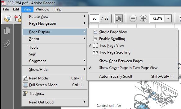

    Google for SSP 254... as a meddling owner these SSP's have helped me alot to gain knowledge of where these modules can be/their names & functions...
    As a tip put adobe reader in two page view, uncheck show gaps, select show cover... then view page 36 & 37 and other two page views will also be correctly laid out...
