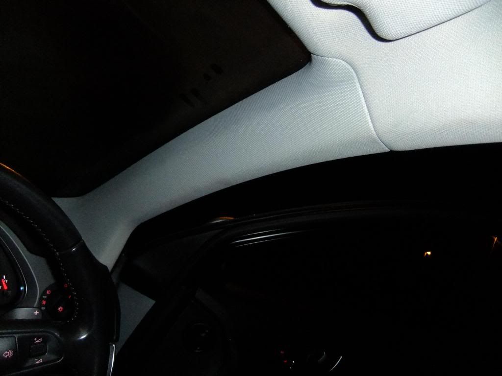

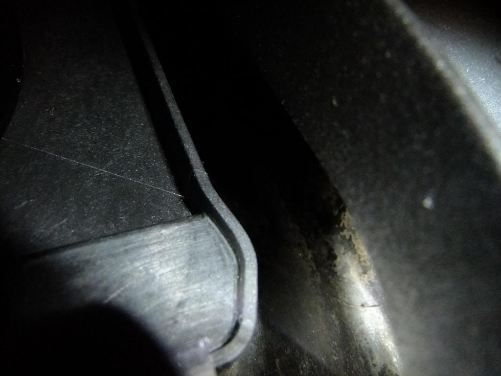

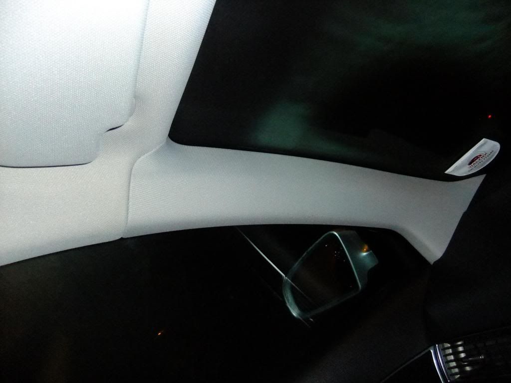

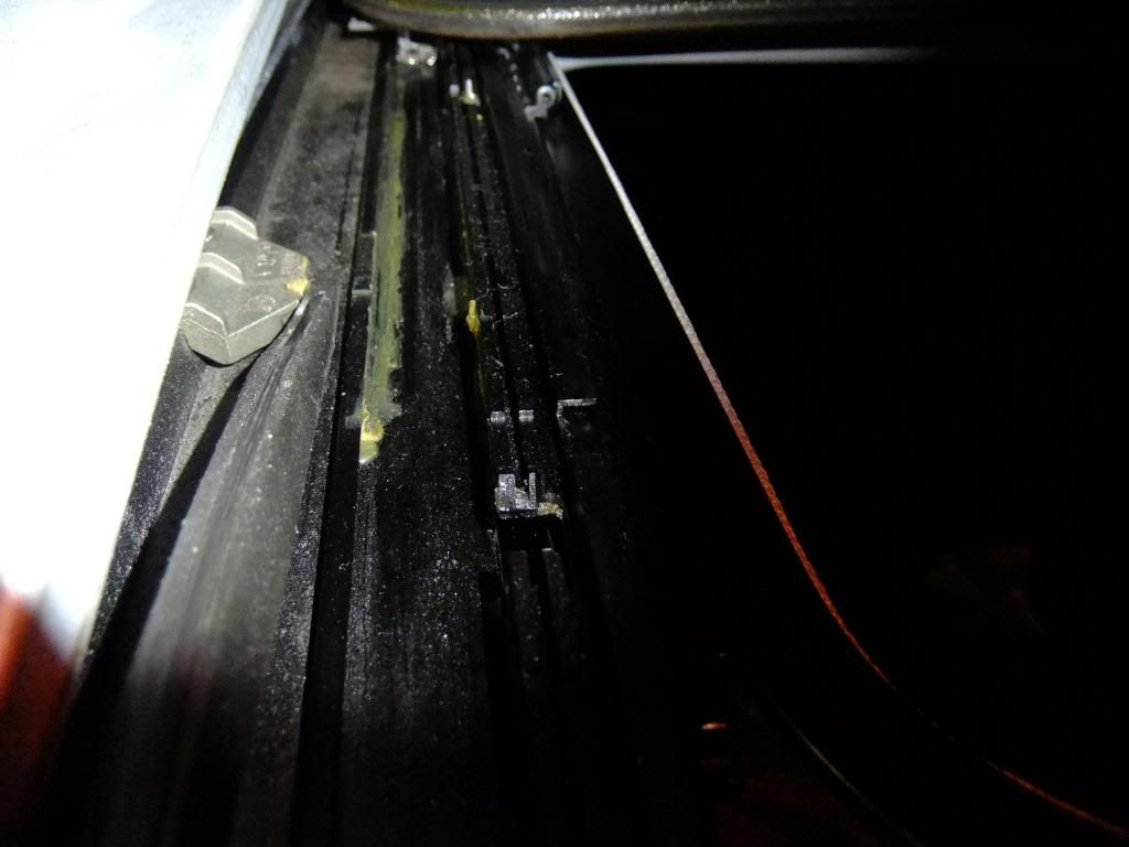

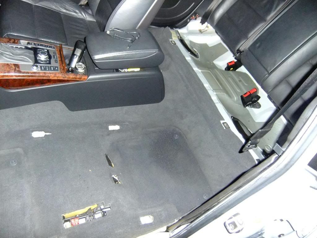

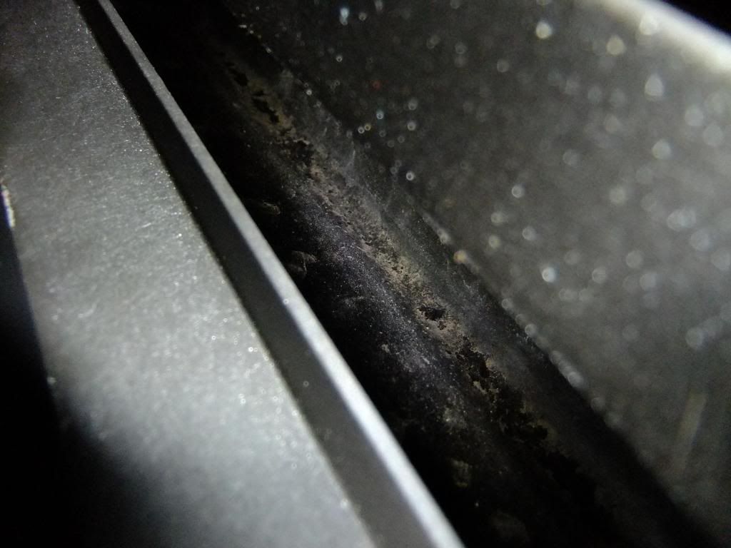

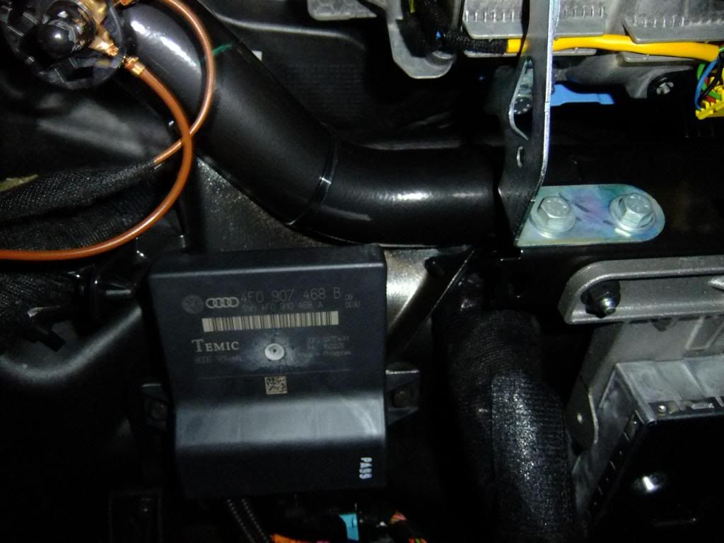

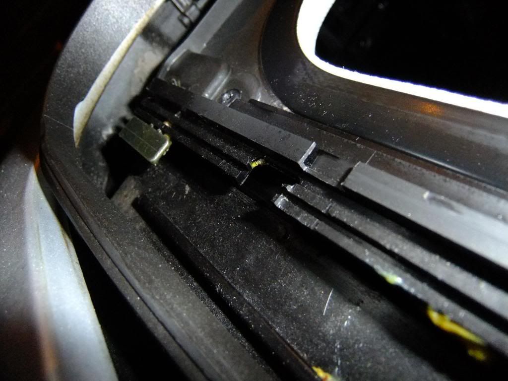

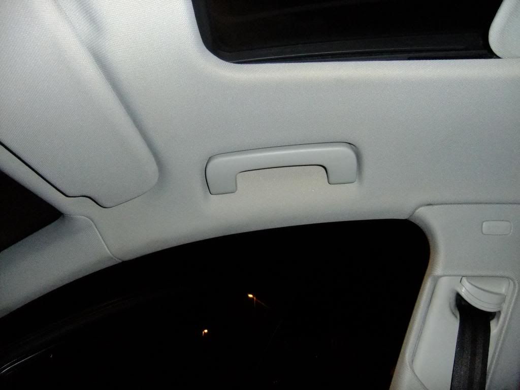

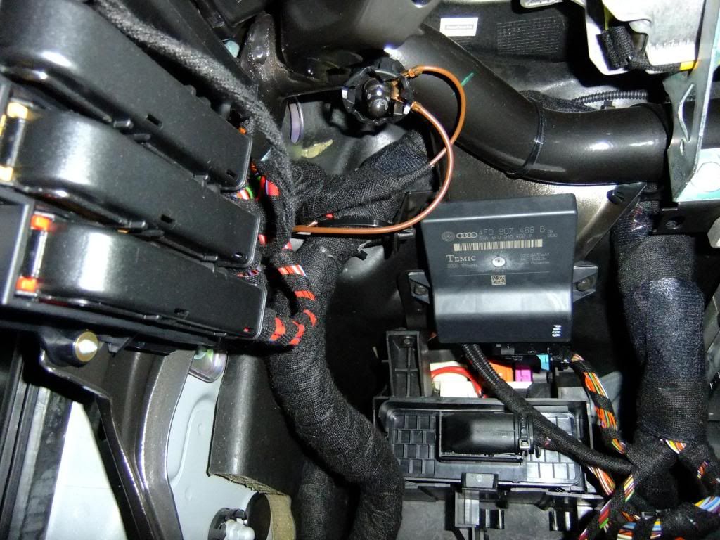

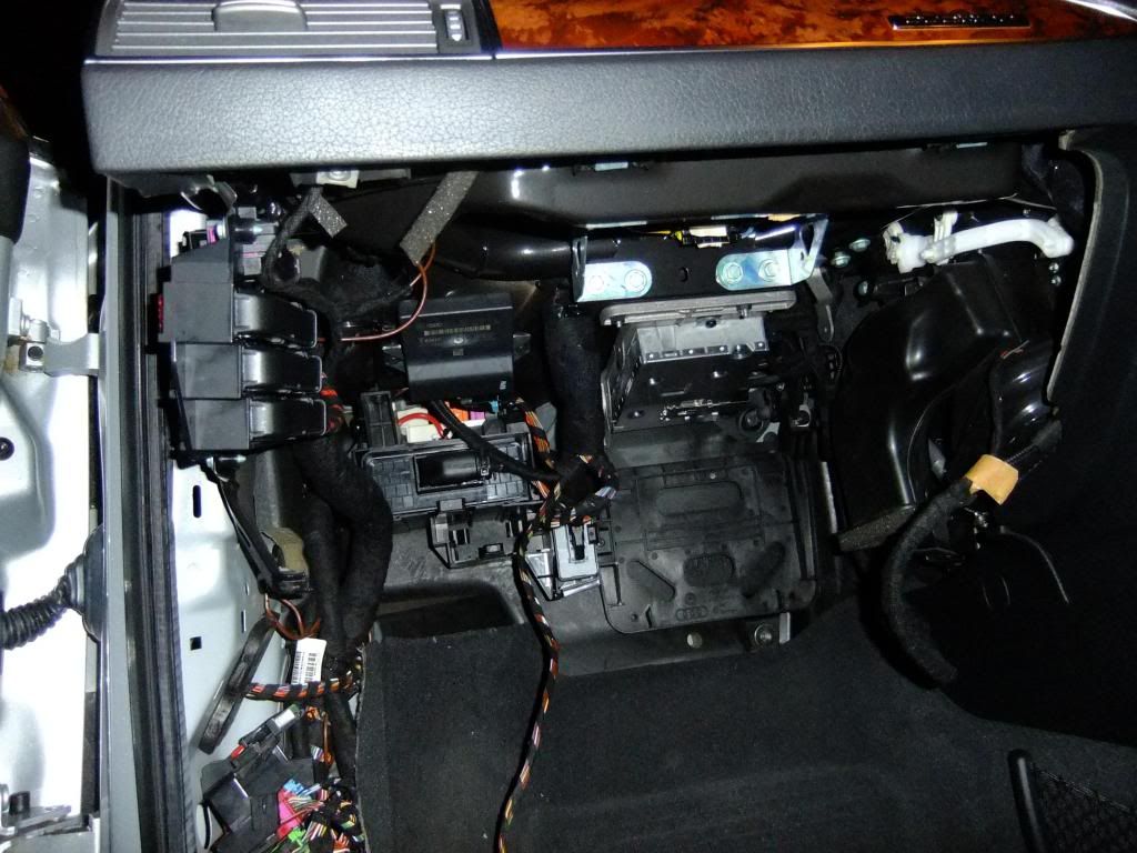

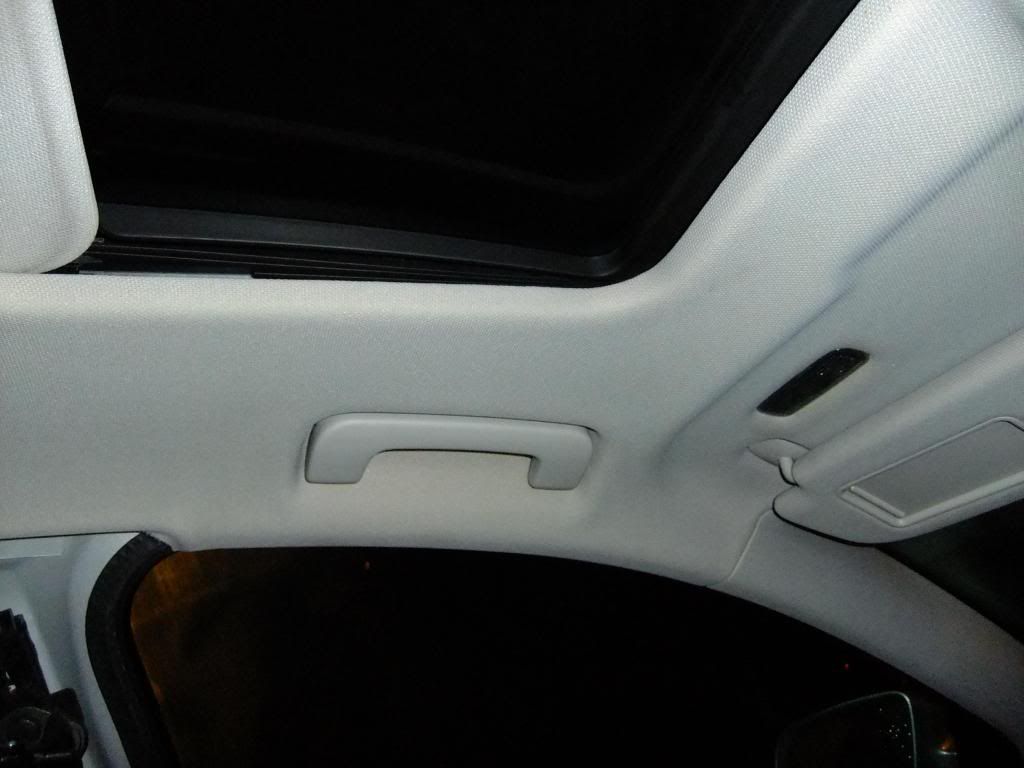

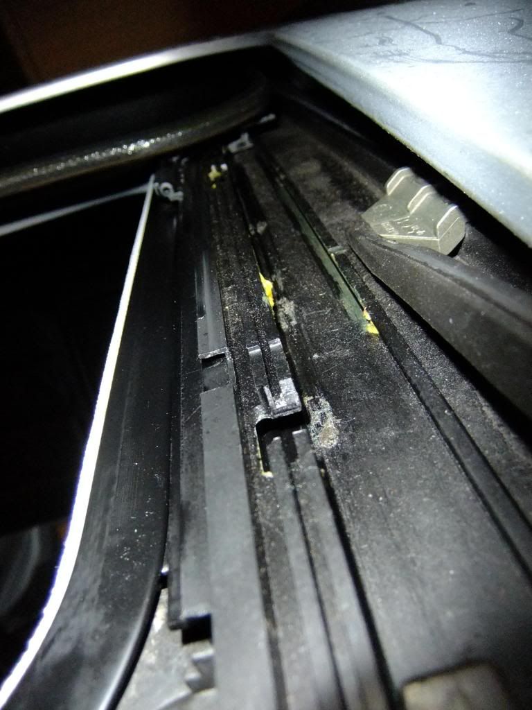

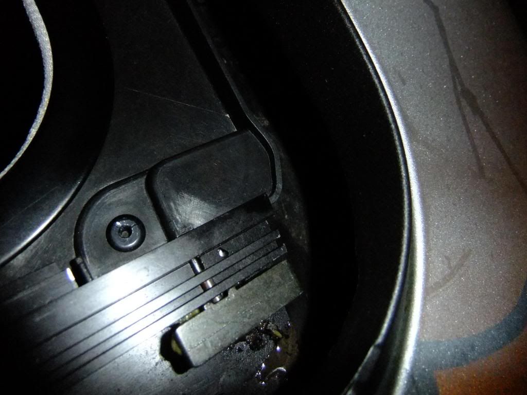

    Besides the sposhing of water... when I lifted the rubber mats they had the tell tale condensation... when I place my foot in rear footwell.. it squelched... note the damp water spot... usually as child car seat that side no one put their feet there...
    This was the only water in sunroof tiny spot on drivers side front my guess from when open roof now...
    Front corner drivers side... ie towards windscreen... dry as bone...
    Front main channel parallel to windscreen... dry as bone...
    Passenger side front corner... dry as a bone...
    Drivers side... take shot from front to back... again dry as bone...
    Passengers side... take shot from front to back... again dry as bone...
    Inside shots...
    Behind glovebox...
    All dry as a bone to touch and sight ... other than under carpet passenger side...

    I think i'd still want to test the sunroof drain hoses are clear by running some water into them and watching it exit to the exterior. You could also play a hose onto the windscreen bonding while checking inside under dash on passenger side.
