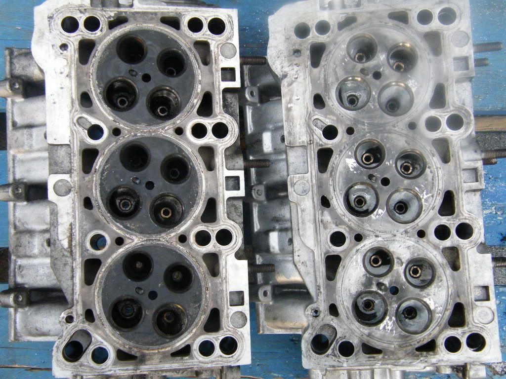

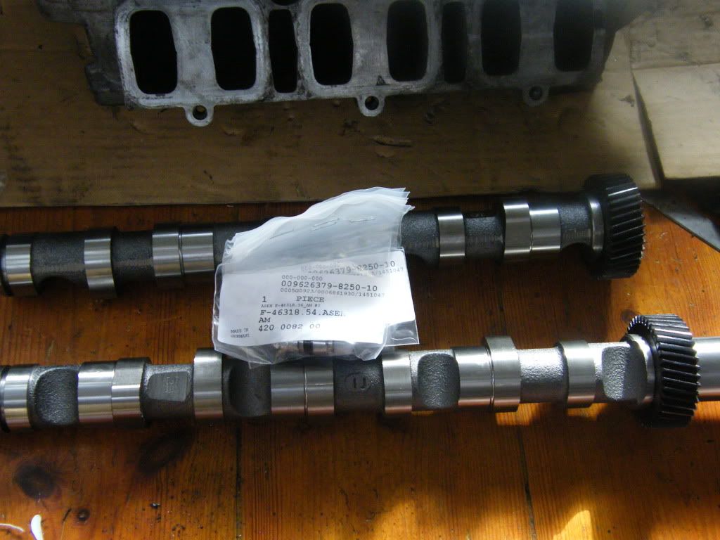

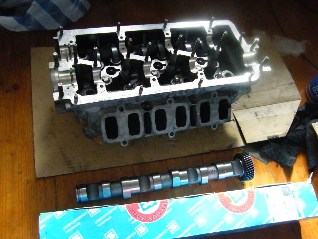

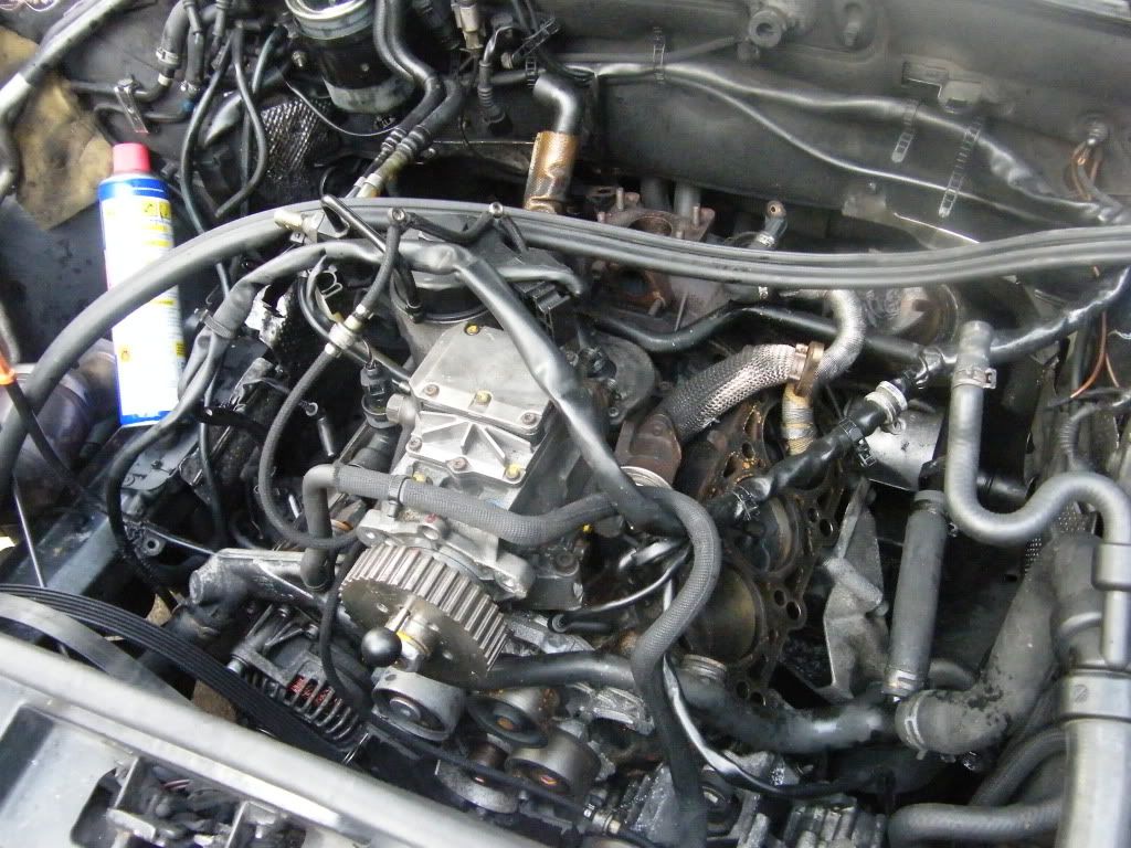

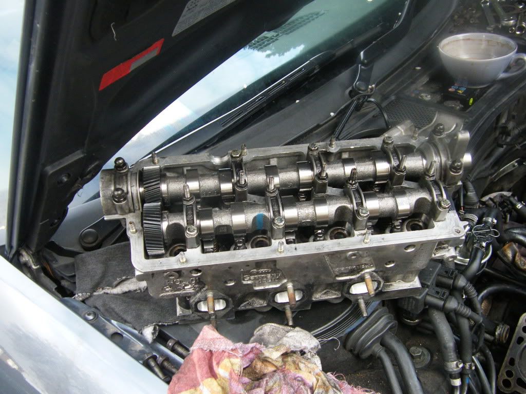

    Cam failure is common on early v6 with cast cams IF longlife servicing and low revs are used. The cams/rockers and lifter wear if crap oils are used and replacing them for forged items is the solution.

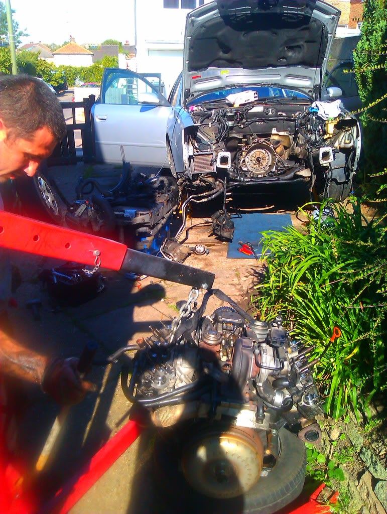

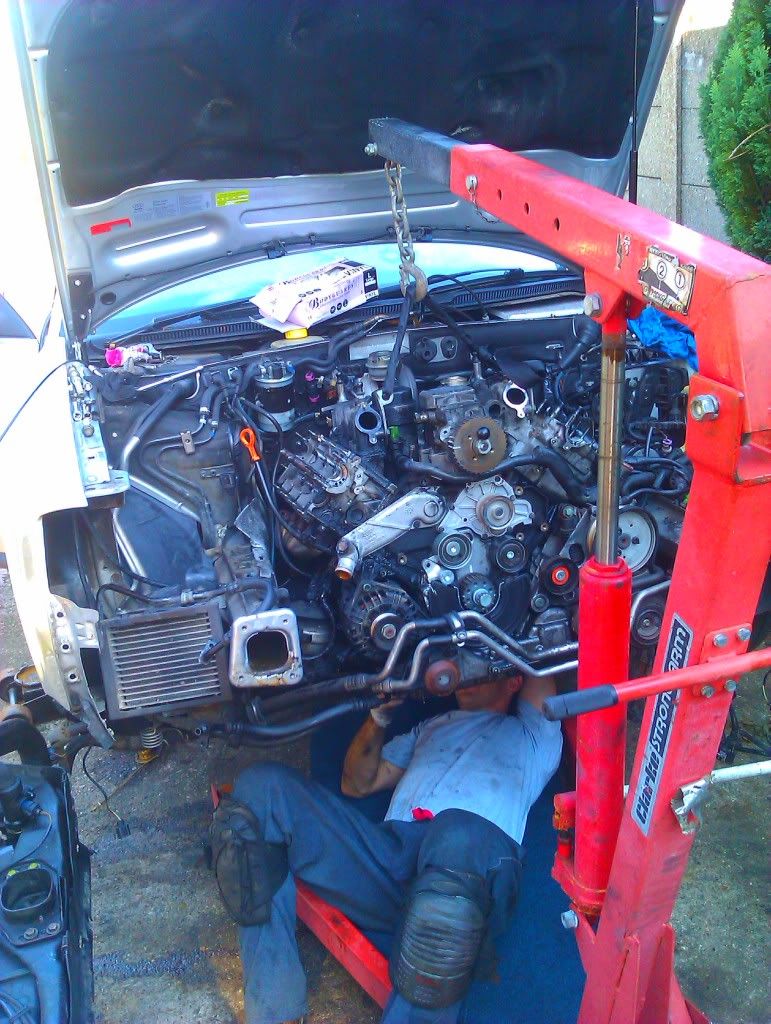

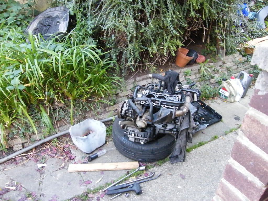

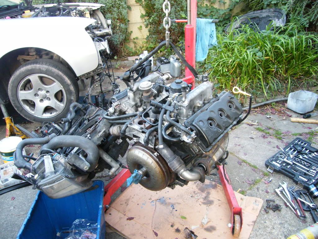

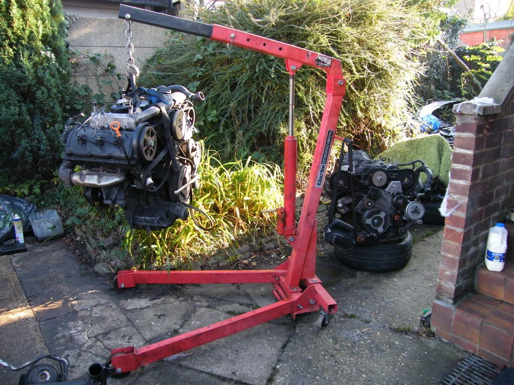

    I have rebuilt my w reg allroad (and many other v6 tdi ) following dropping a valve due to worn cams, the rockers get dis lodged and ratle about till the cam lobes push them onto the valve which breaks the stem (by the cotter end) and it drops smashing the piston/head and often the injector on that piston !
    I used Kolbenshmidt forged cams and INA forged/DLC coated lifters and rockers, no issues to report after 80k of hard life, mainly towing 2-3 tonnes at a time !
    As pointed above, it's a reliable engine if looked after, not as reliable as the old inline 5 cyl AEL engine but much more powerfull and torquer in stock trim...
    Check pump timing and look for needle lift injector faults, they will make the engine sound coarse...
