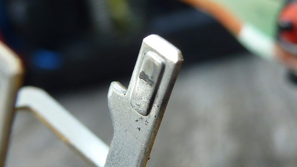

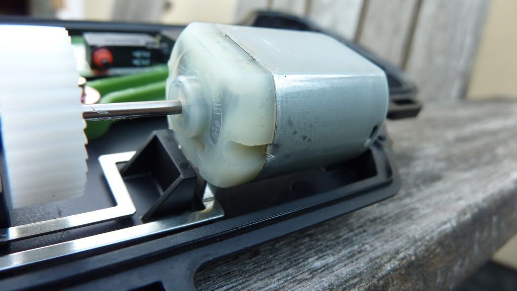

    I see you have an 02 Passat, I have one also, it has given me no problems with any of its locks over the 4 years I have had it, the 05 Passat has given me hell with 3 out of 4 locks failing inside 9 months. I have replaced the locks with ones from 02 cars and no problems since. The later version of lock is rubbish, you can tell them apart as they have a black cover as opposed to the green on the earlier locks. The motor is mounted on 2 copper buss bars, the torque twists the motor causing arcing on the copper contacts, I tried cleaning and refitting, it lasted 6 months then back to hell!
    On an 05 Passat I would bet it is the lock not the wiring!
    see here for arcing on contacts

    and here for absolutely crazy motor mounting (look ma no brackets, it relies on pure faith)
    http://i52.photobucket.com/albums/g1...t/P1110602.jpg
