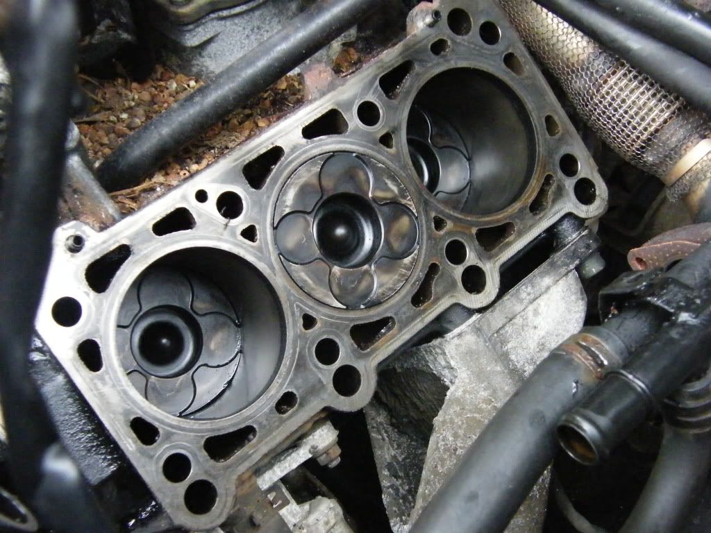

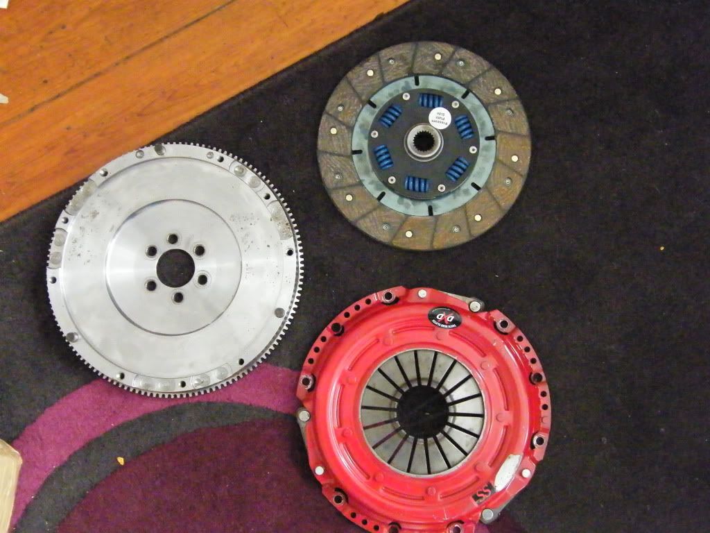

    As Zollaf mentioned above, don't bother. Just get yourself a gtb2260vk from the 3.0 tdi 244Bhp engine, a set of bosio race 683 nozzles and a custom remap- best way to get 250-300 bhp out of your 2.5 tdi ! Here's mine, ran 266 Bhp on the dyno with a worn engine, dodgy turbo dynamics hybrid charger and not balanced race nozzles:

    1 1 0
