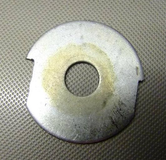

    I did create a restricting plate using a large flat washer (38.5mm Link:- Halfords )and dremeled the ends to allow the bolts on EGR connecting pipe...
    So washer in place, MAF connected... when car started it still idled rough... but sorted it self quicker... whilst running I disconnected MAF and I noticed a change in engine idle noise... more smoother... the moment I connected MAF I could see the slight rocking and uneven idle come back... besides undoing the EGR connecting pipe at the throttle adapter on the top section of intake manifold... I had to undo the the manifold to allow movement to add plate... one thing I noted how quickly washer discolour... what bad effect EGR must have on engine
    I did not go for test drive as I felt idle not smooth so what the point...
