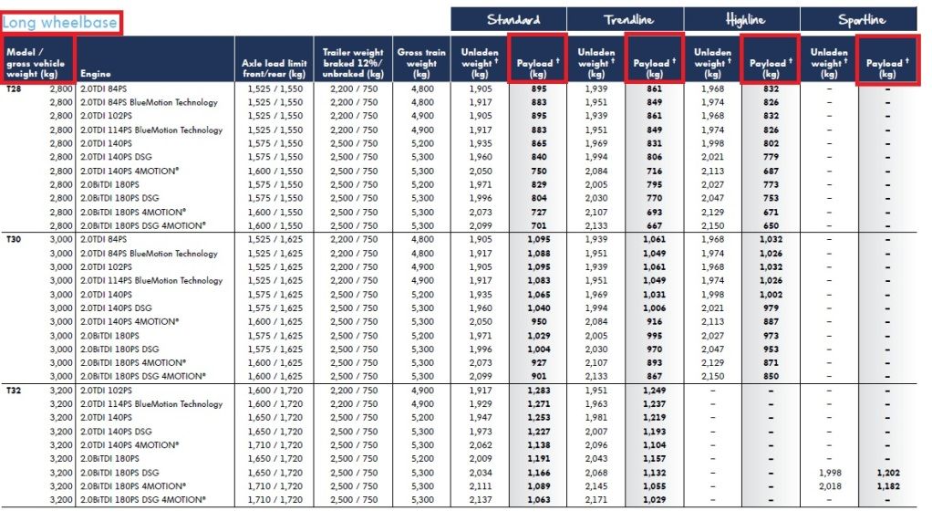

    Can someone explain what is the difference between the two please?

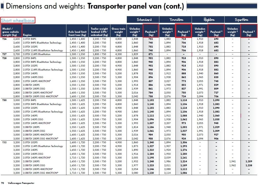

    The numbers after T denote gross vehicle weight so T30 = 3000Kg , T32 = 3200KG...
    Which then equates to different payloads, so T30 Approx. 1000Kg , T32 Approx. 1200Kg
    But these payloads depend on i) version of transporter ie panel van, kombi, chassis cab ii) length of wheel base/body length eg short or long iii) roof height ie low, medium, high iv) optional equipment
    Link: Volkswagen Commercial Vehicles (UK)
    On the above linked page go to "Size and Space" then "Weights" and you will size a table of models with data on payload,etc
    From the grey top bar if you select "Company" then "Downloads" you can get a brochure....
    Below from the current brochure for a panel van PDF page 36 (70-71) has this data as well...
