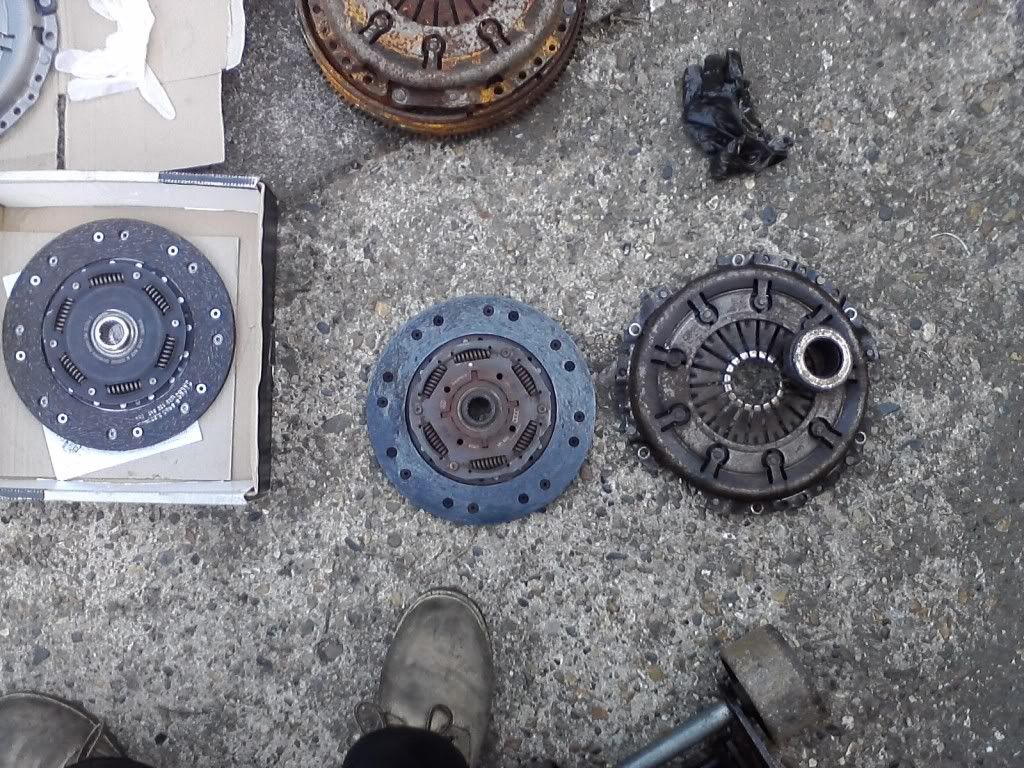

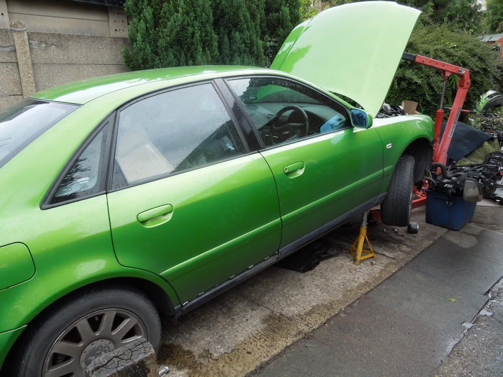

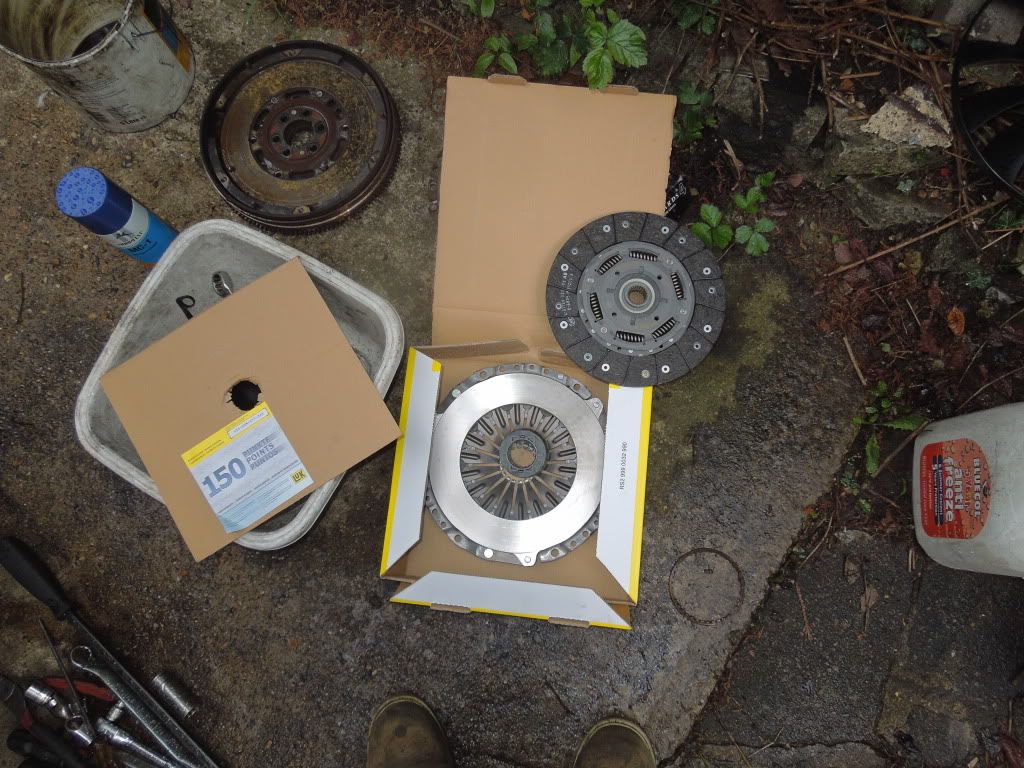

    One thing to remember is the propshaft bolts are very tight and you will need a good breaker bar + you need to mark the flange where it mates with the prop so they go the same way. here's another one i've done, this time on a AWX engined a4 which is identical to the passat bar the front bumper !
