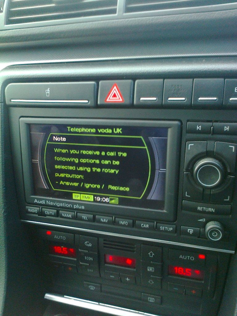

    The bluetooth is working and coming through the speakers etc but it's stuck on this screen...

    What im thinking of now is... Put the RNS-E in someone elses car, code it up for my car and then swap them back????
    Or work out some way of coding it without it being in the car!!
    I've already tried the radio/setup reset procedure to no avail....

    You just need to do a reset of the RNSE - I remember seeing that screen online before.
    Hold Radio and SETUP for a few seconds.

    Remember your coding is 0301517 going by info you have provided.
    Have you coded your BT unit correctly?
