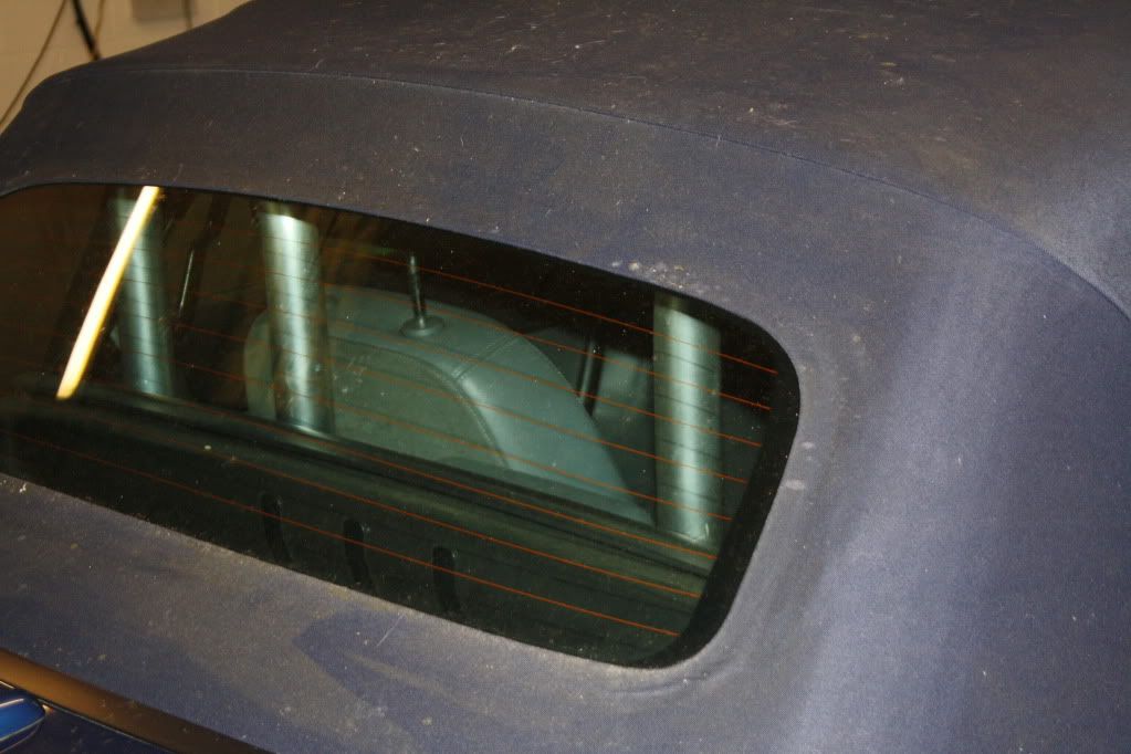

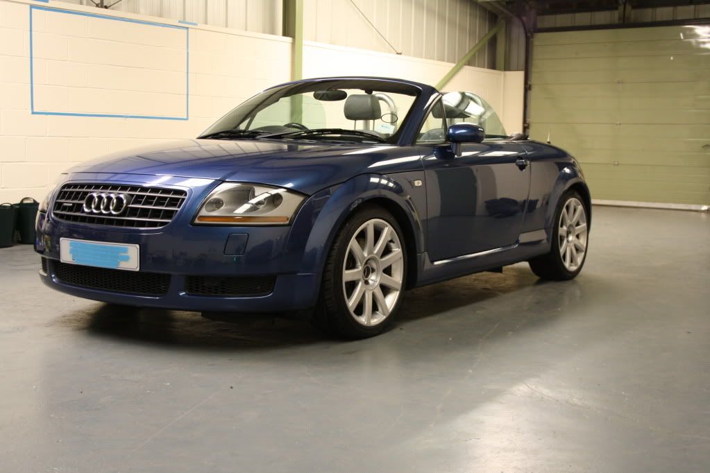

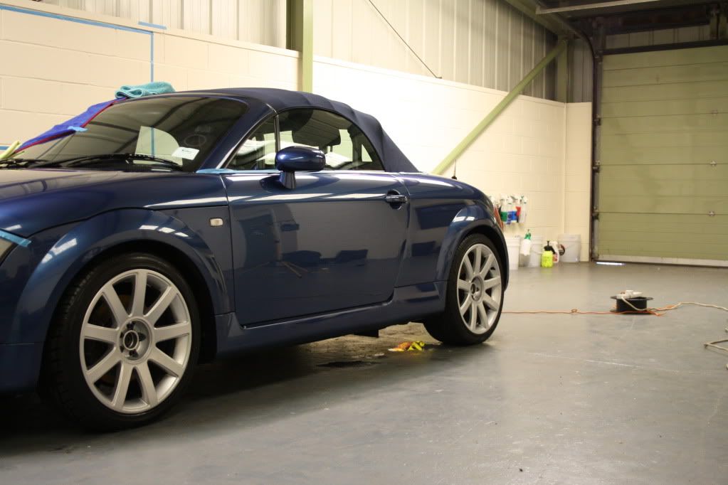

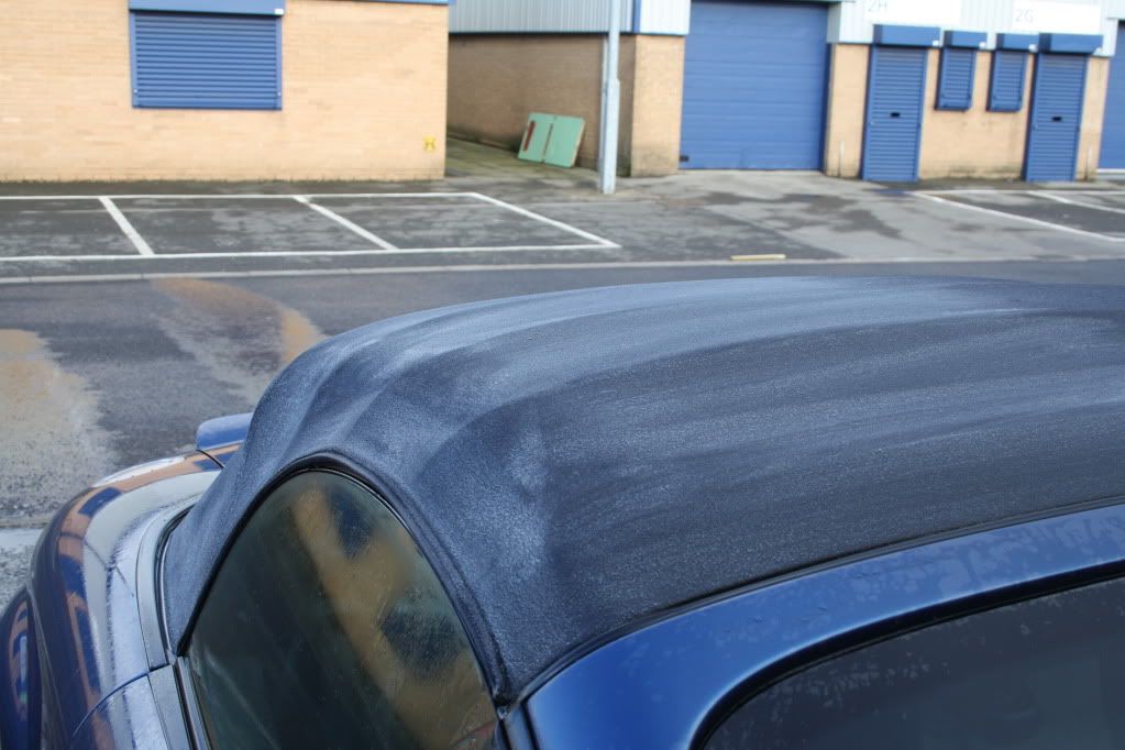

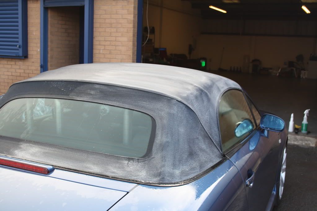

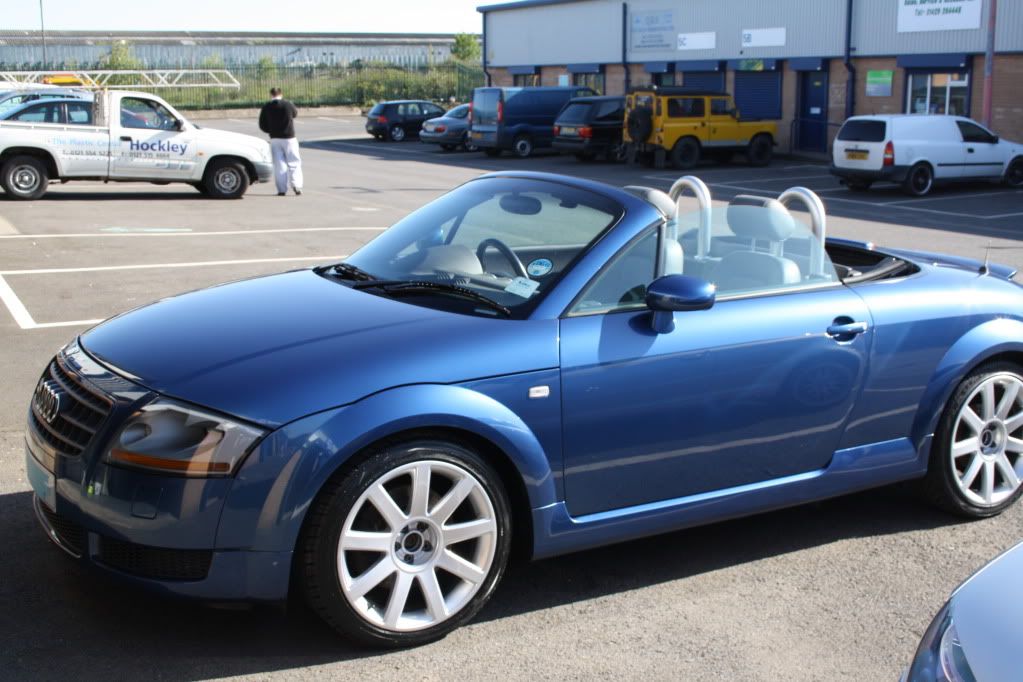

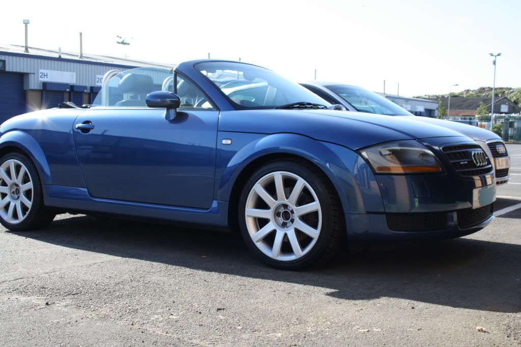

    An enhancement detail on a Audi TT which needed freshing up as the paint had lots of swirls which where stopping any real reflections to the paint work. The dirt build up and mold on the roof was also spoiling the look of this stunning car

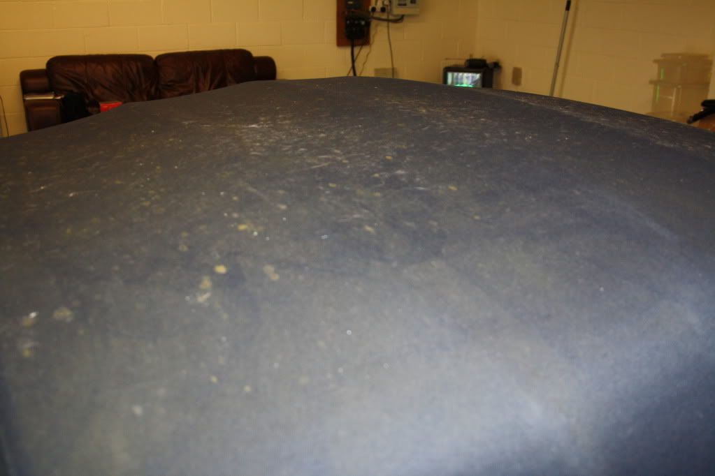

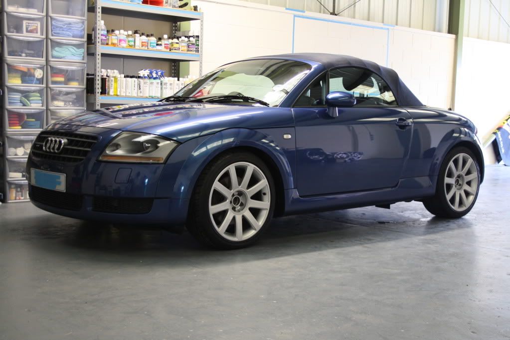

    The roof before cleaning

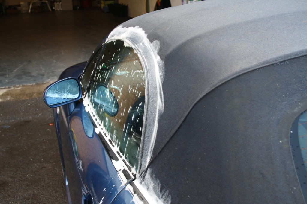

    Cleaning process, The roof was cleaned using the 303 cleaner which I had to do 3 times as the amount of muck and mold on the roof was unreal

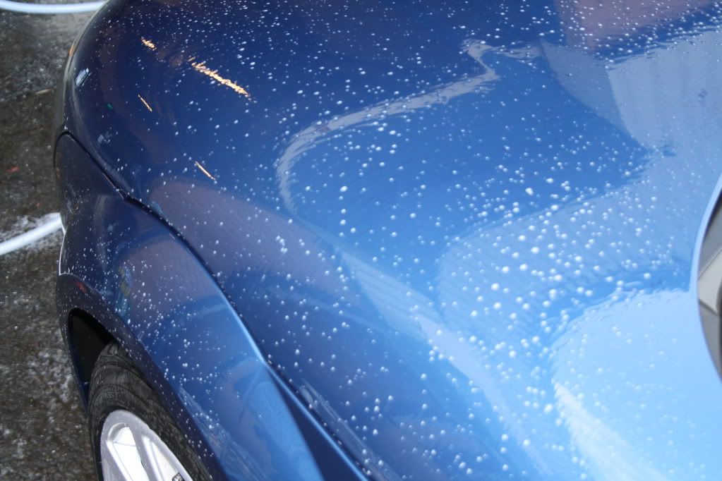

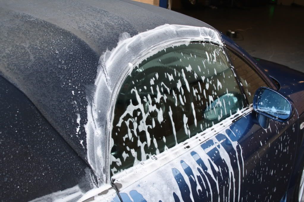

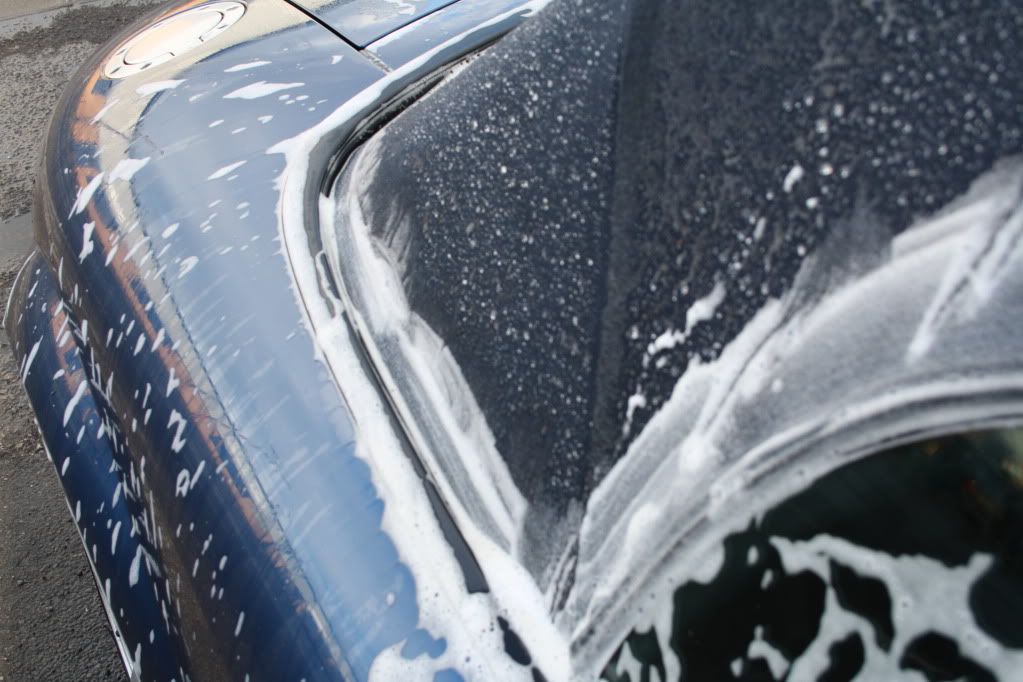

    The car was then given its first coat of snow foam whilst this was dwelling I went round the car using APC in a foaming head bottle cleaning the fuel filler area and various gaps and grills. The snowfoam was then blasted off with the pressure washer, and then the car was given another coat of the same mix snowfoam and then cleaned off again at this point it started to rain so the car was brought into the unit.
    The car was washed using the 2 bucket method with grit guards in both buckets and a Carpro lambswool wash mitt.

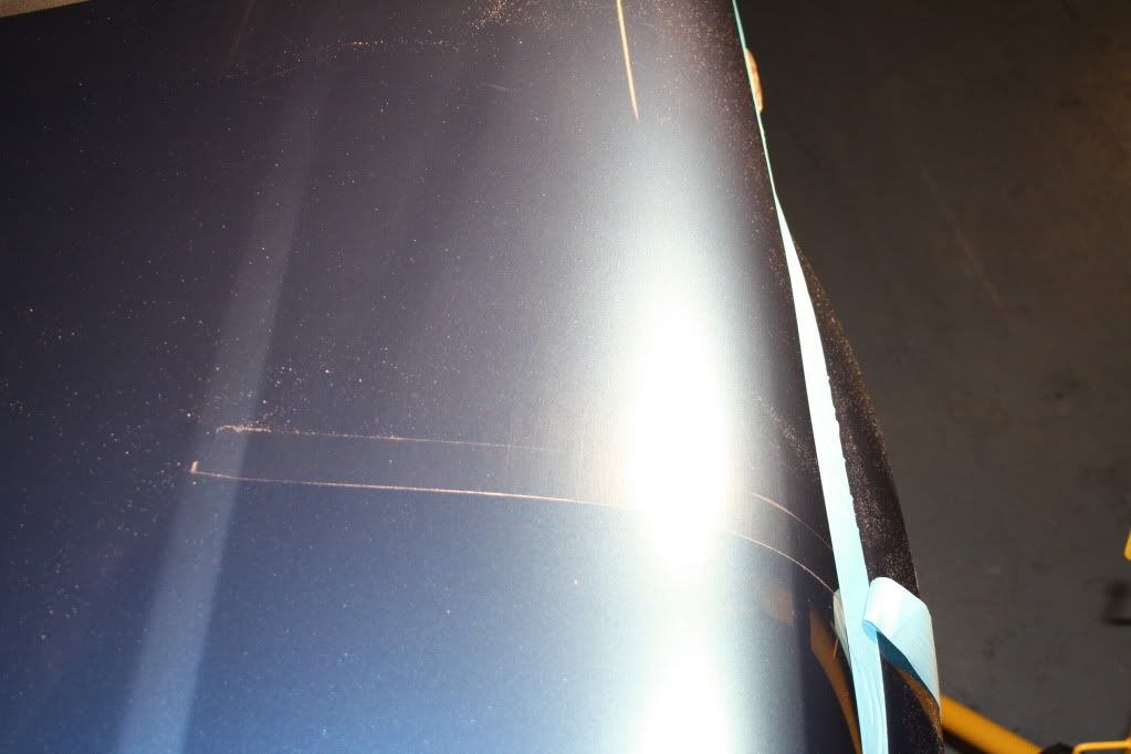

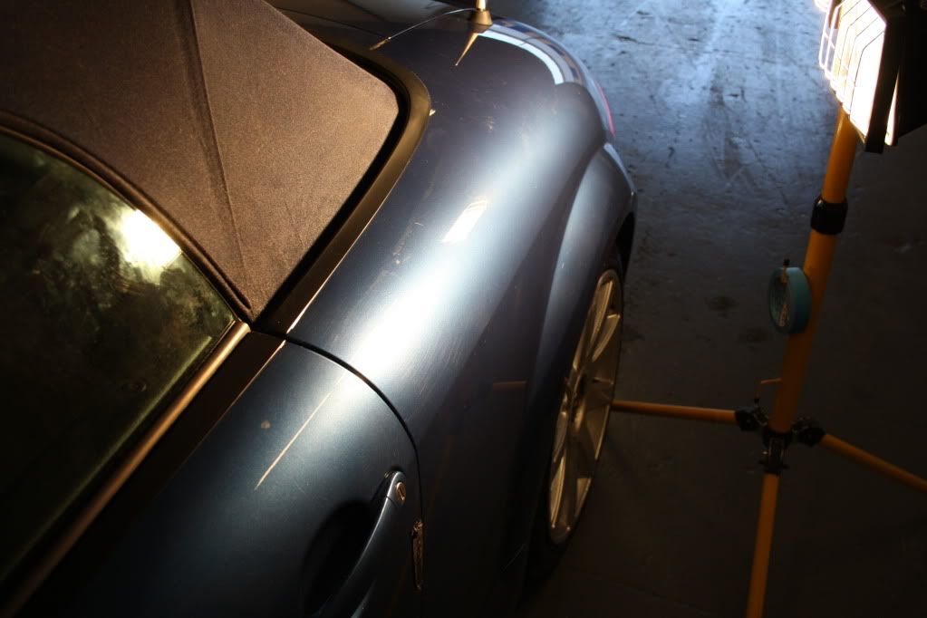

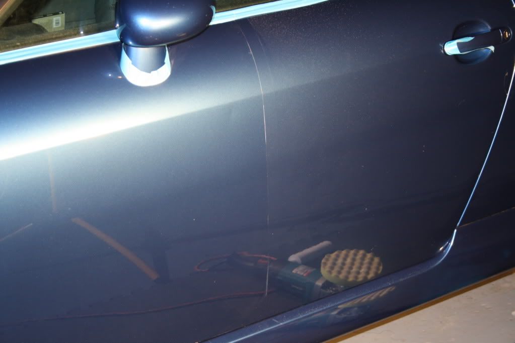

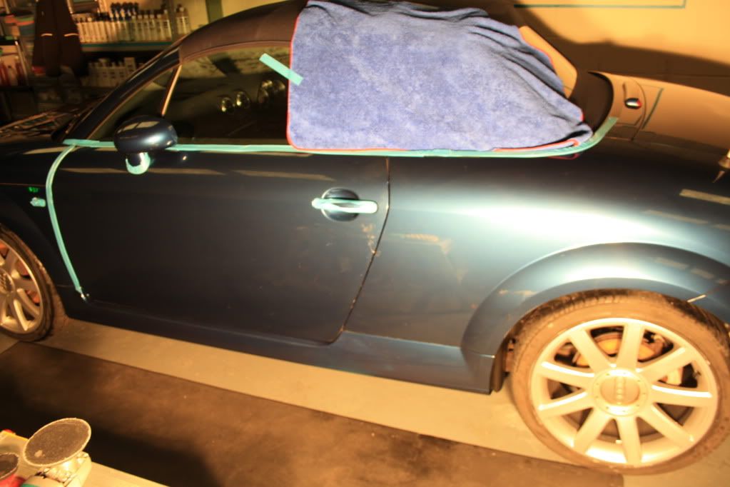

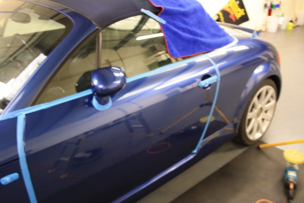

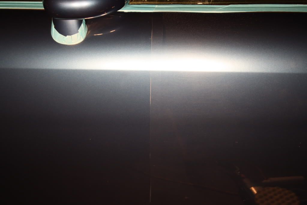

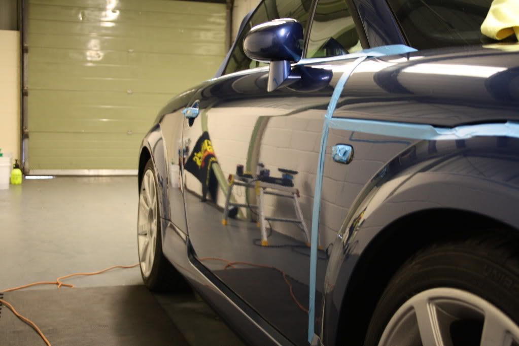

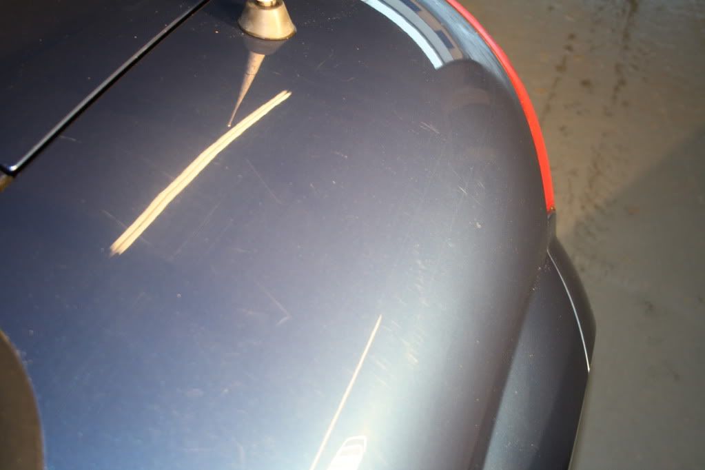

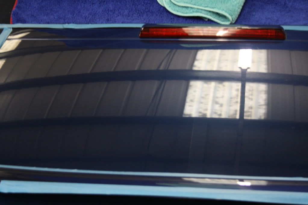

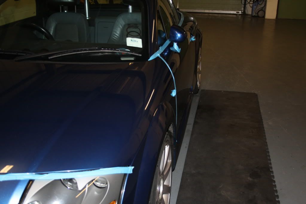

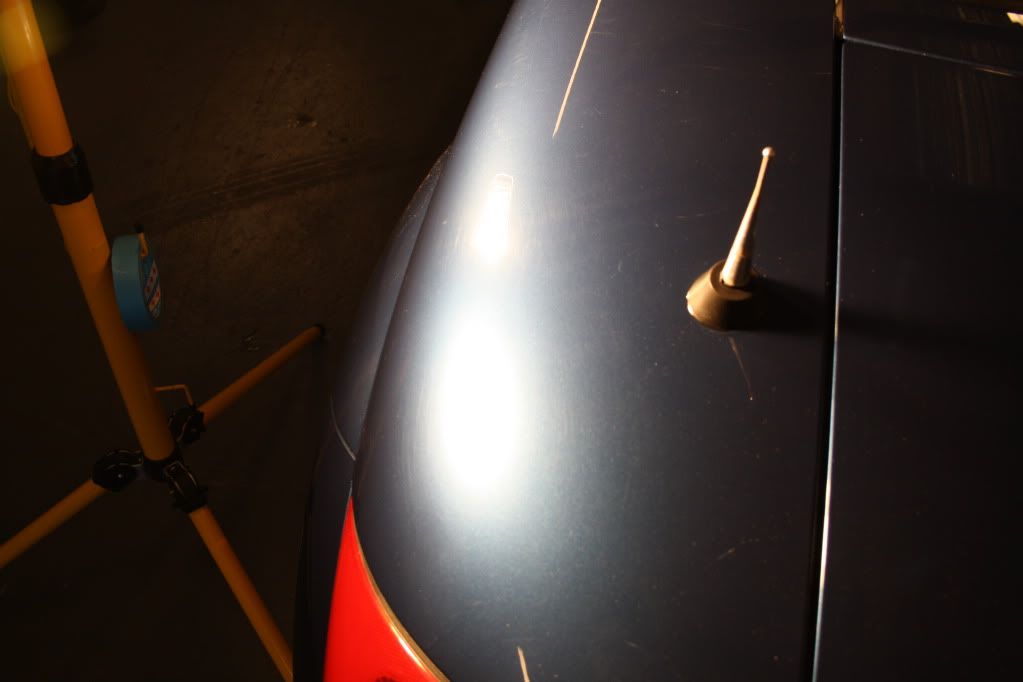

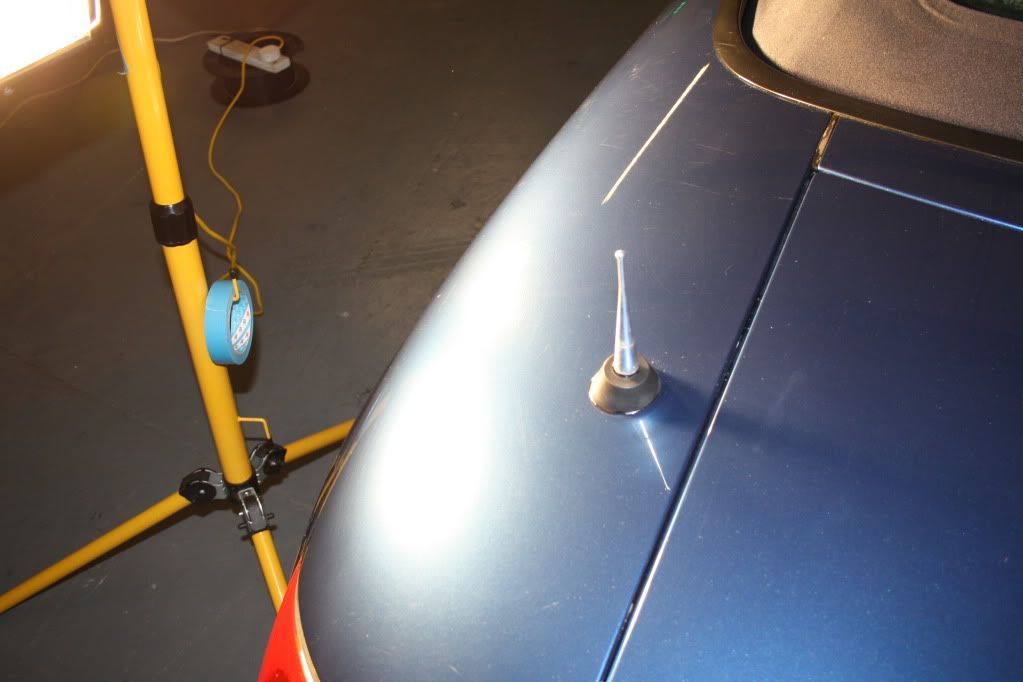

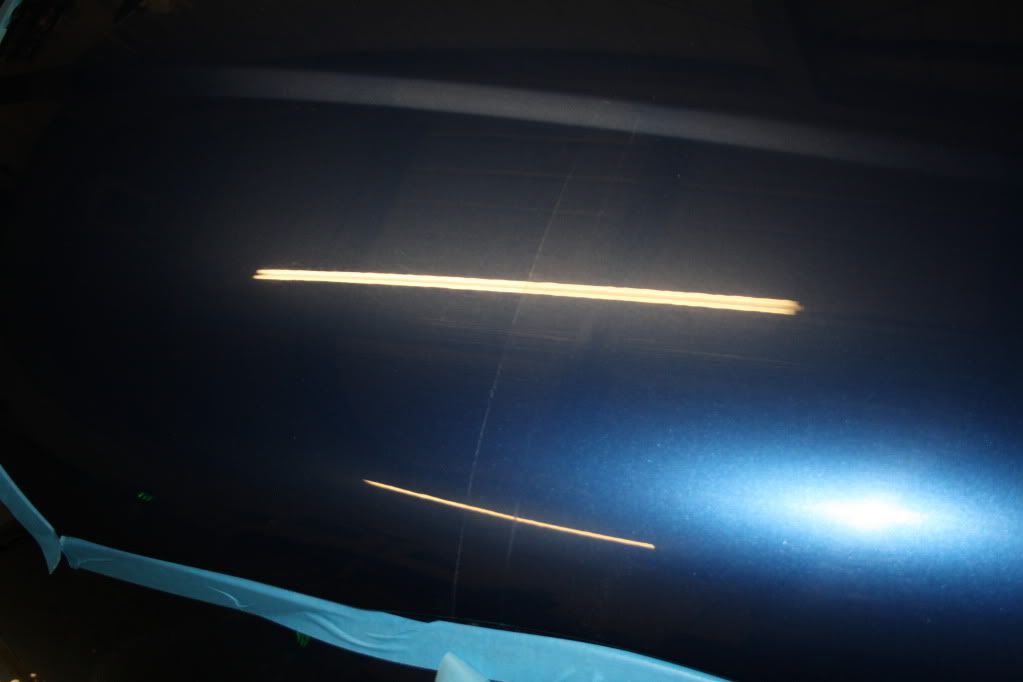

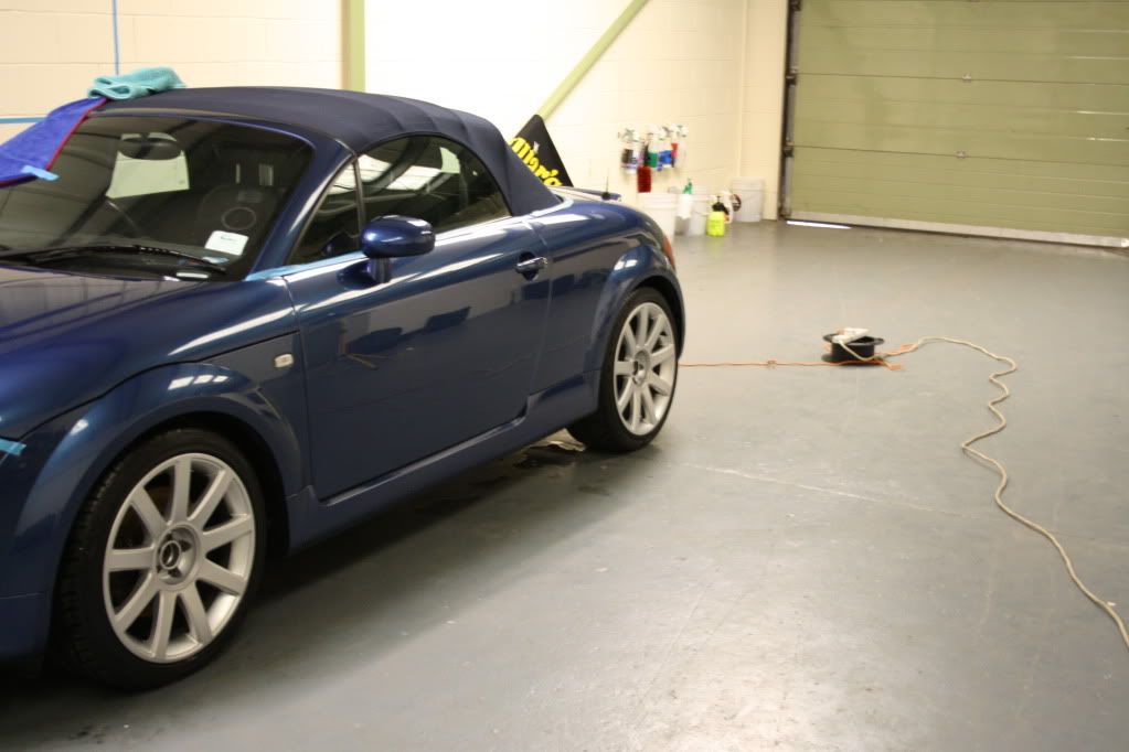

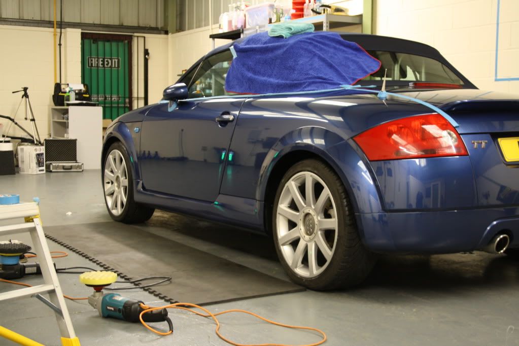

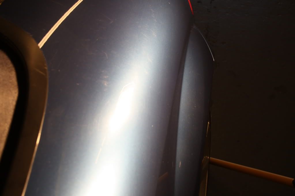

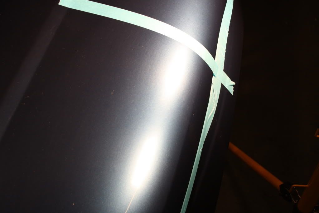

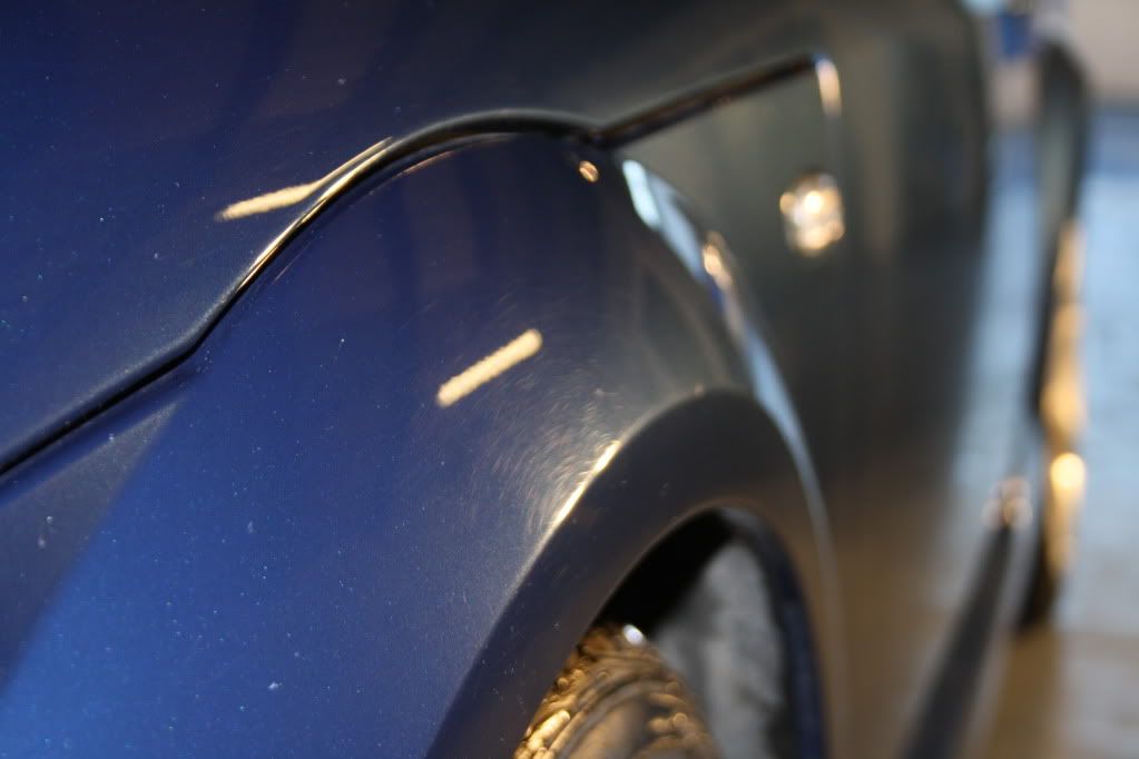

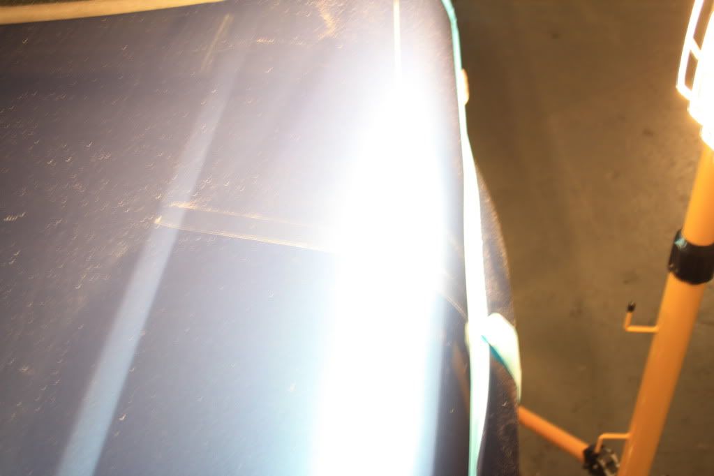

    The car was then brought inside for taping up and paint thickness readings to be taking and some photos of the defects on the car.

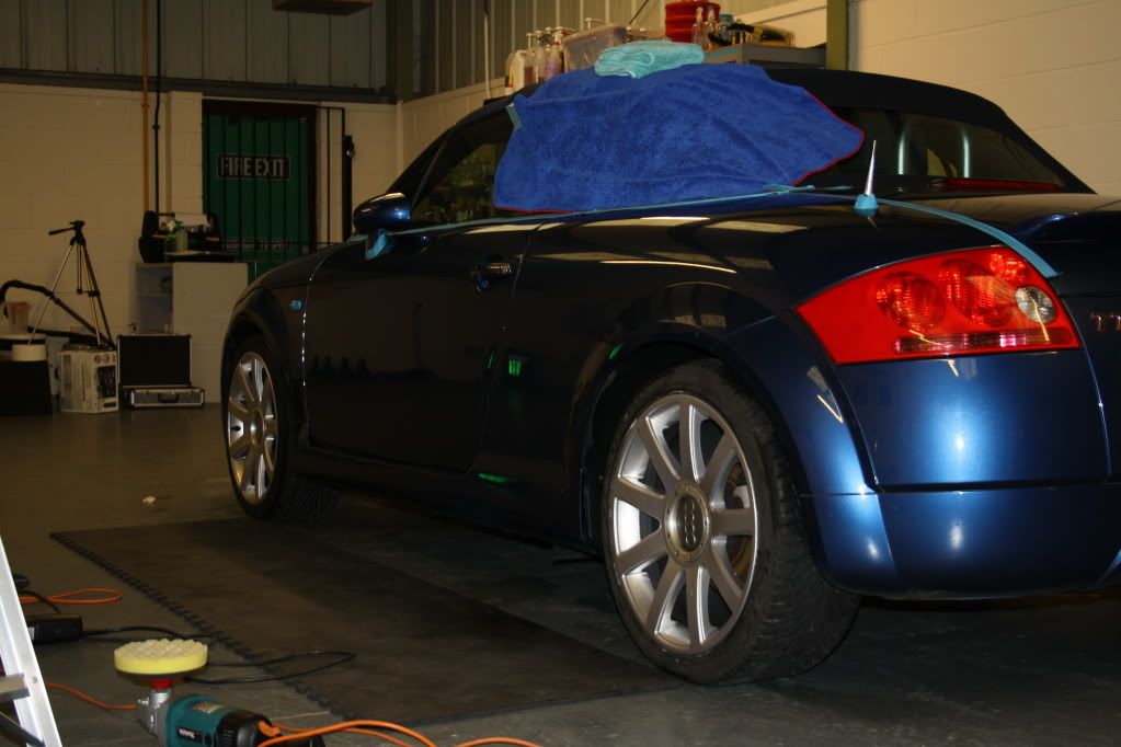

    The car was polished using Carpro Fixer polish with yellow 3m pads and my Makita rotary polisher
    50/50 shots

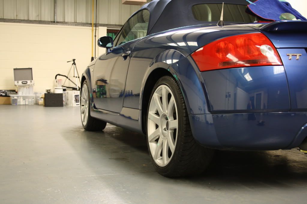

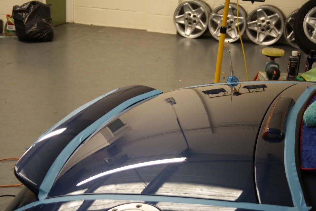

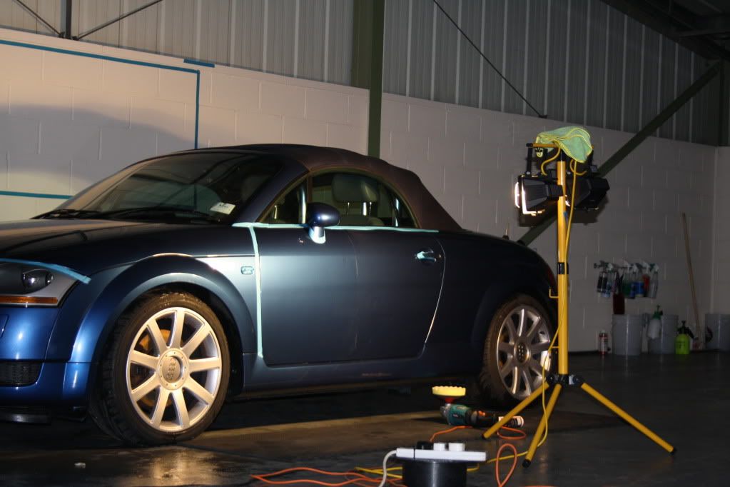

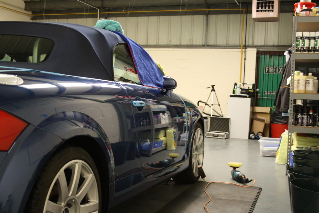

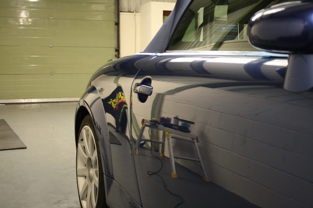

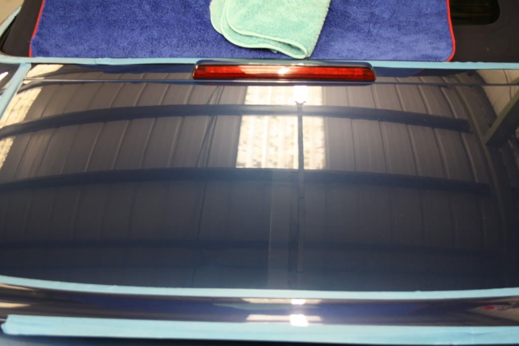

    Started working my way round the car

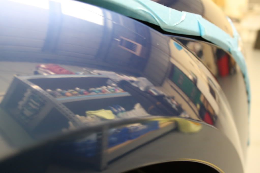

    After polishing I went round the car with Carpro Eraser to remove any remaining polishing oils or fillers, I then went round the car again with Britemax Blackmax and a black 3m pad using a DA polisher

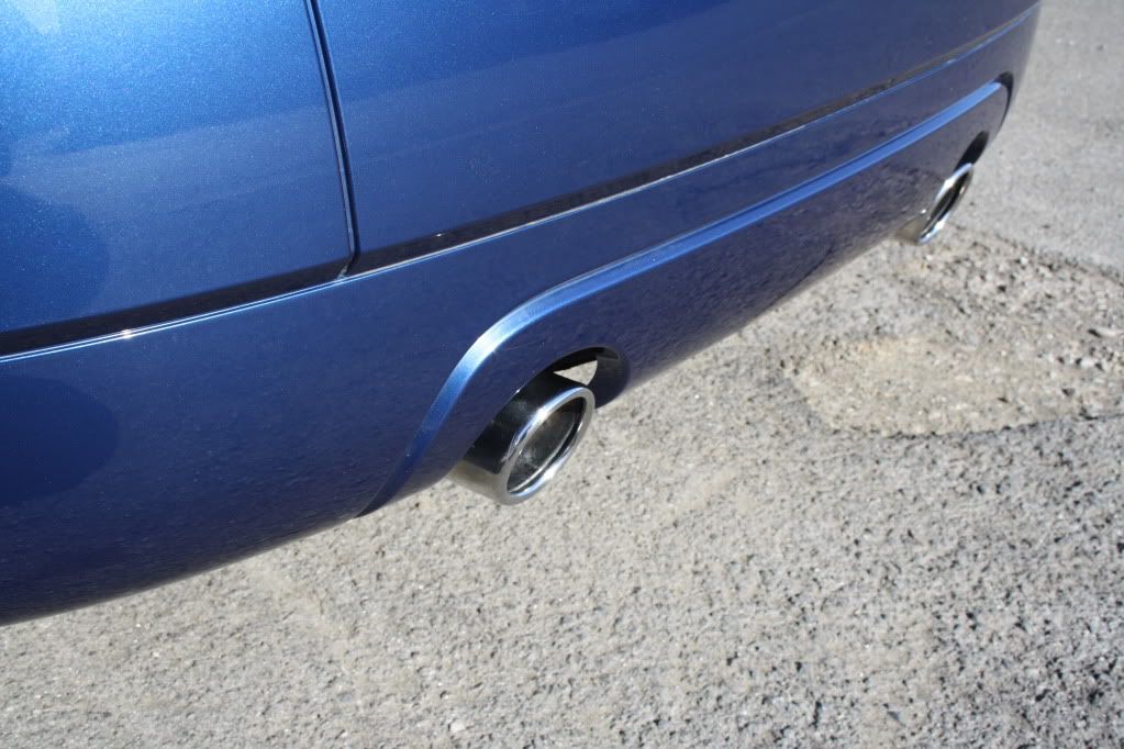

    After the polishing was out the way the car was taken outside for a rinse down before being dried and the roof given its first coat of 303 high tech fabric guard also at this point the arches where dressed using Meguiars hyper dressing the alloys sealed using 2 coats of Jetseal 109 and the tyres dressed with Valet Pro tyre dressing. The next day the car was given its second coat of 303 high tech fabric guard and whilst this was drying the interior was given a hoover out and the leather seats cleaned and sealed using Furniture Clinic products. The exhausts where cleaned using Autofinesse metal polish and 00 grade wire wool.

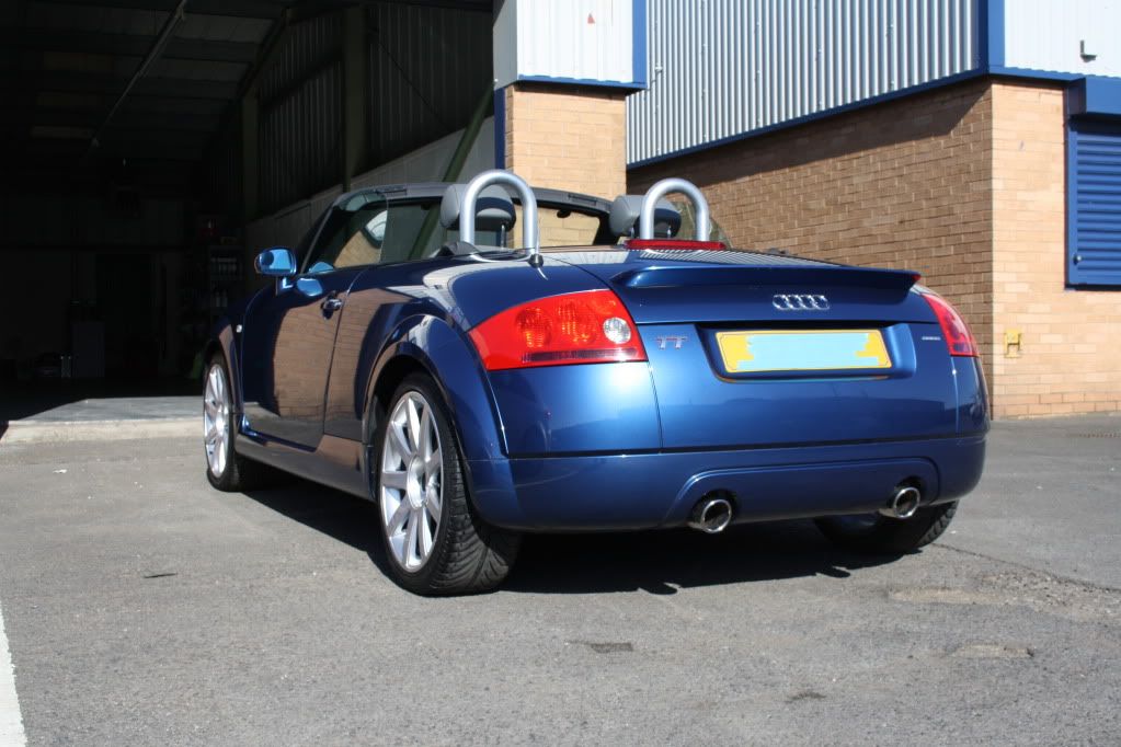

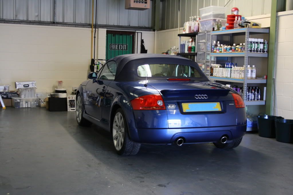

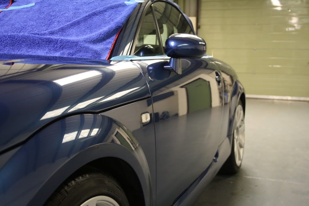

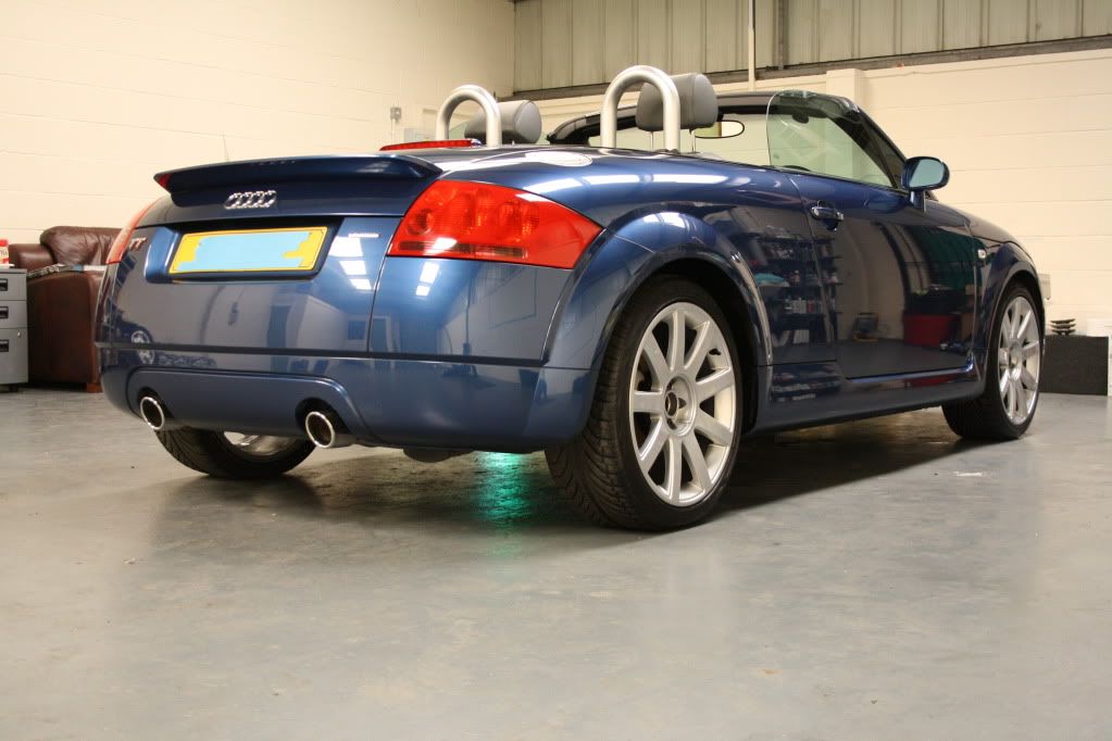

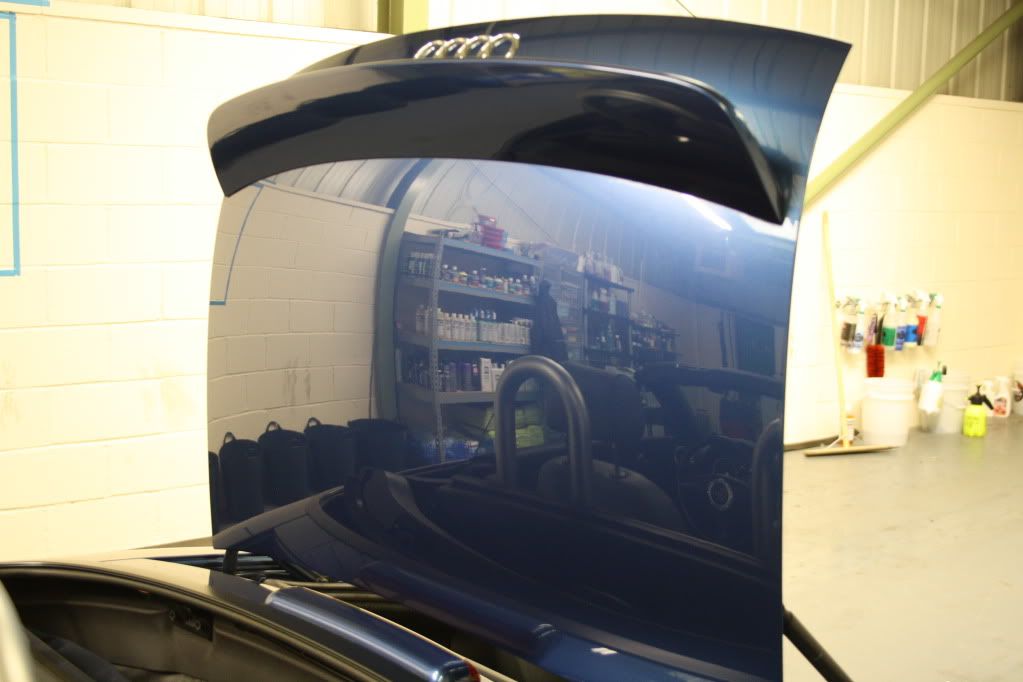

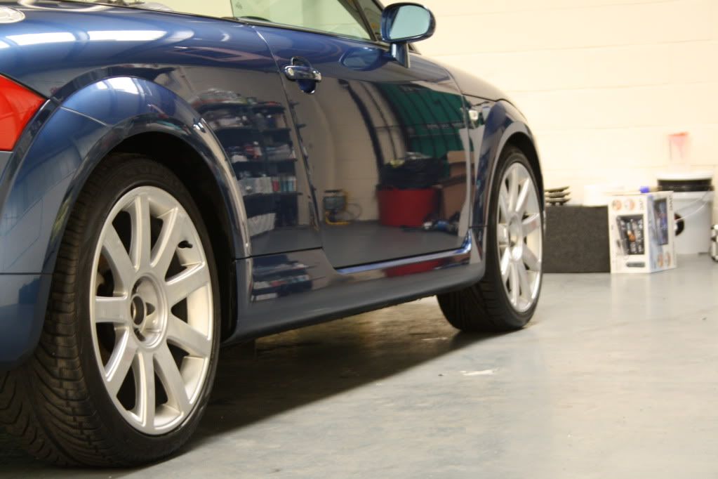

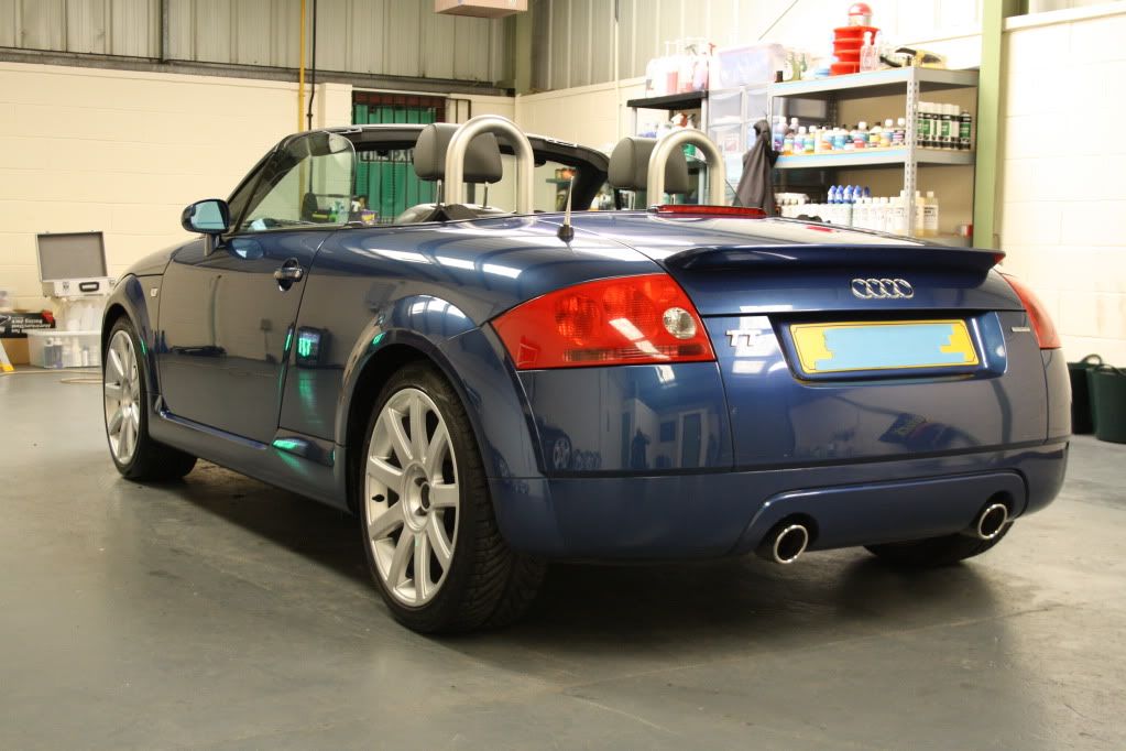

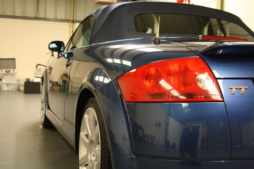

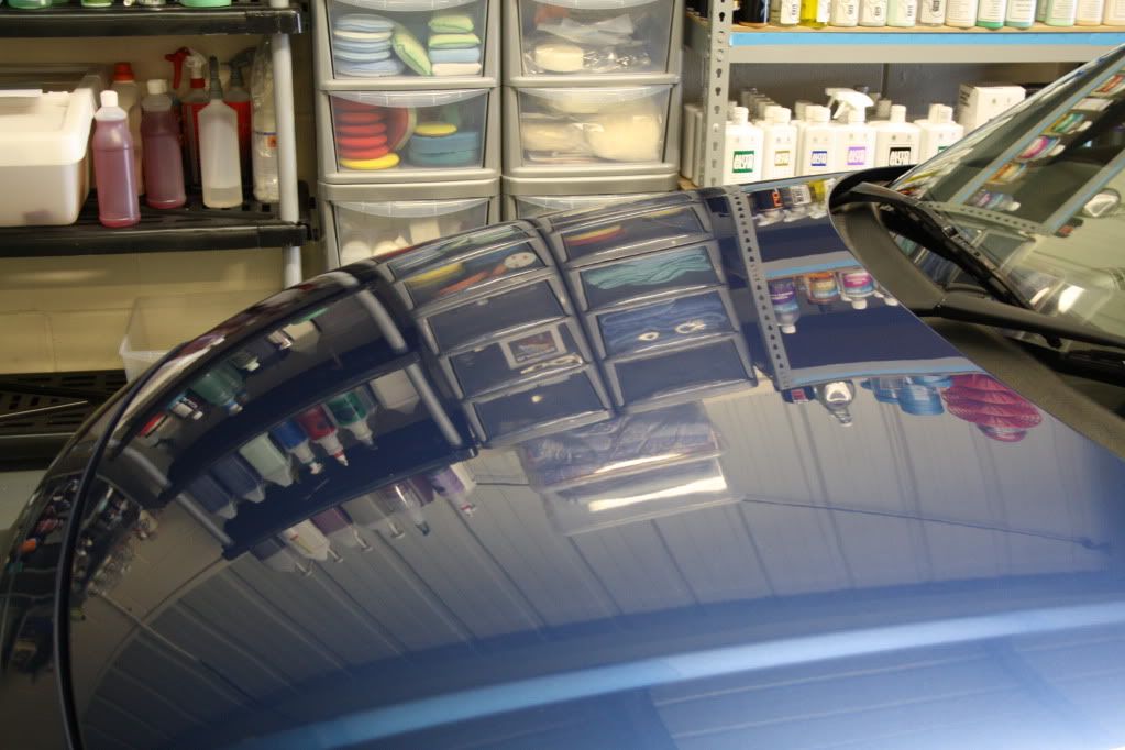

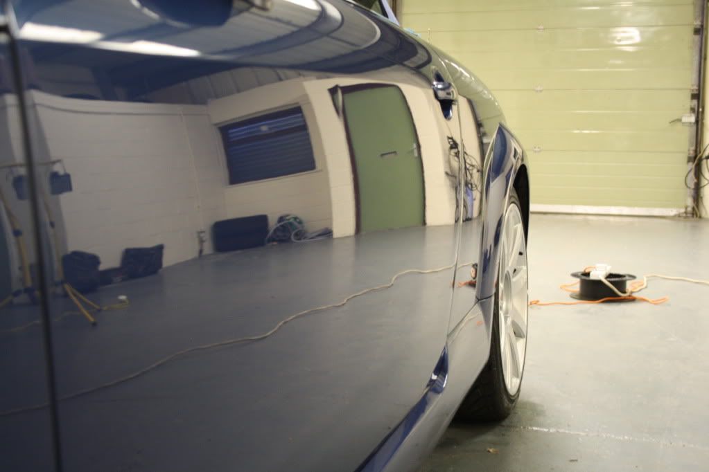

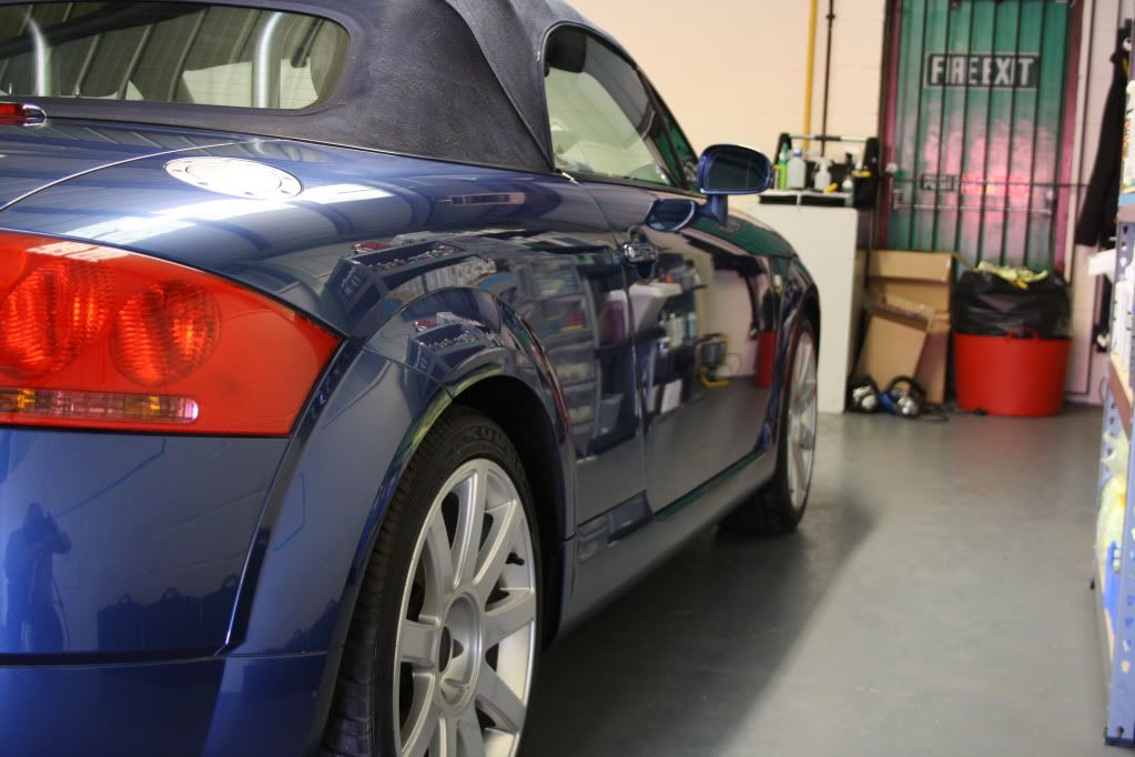

    The car was then given 2 coats of Chemical Guys Celeste Dettaglio paste wax which was applied thin coats and buffed after 30 min leaving 60mins between coats.
    Leaving me with this
    The plastic trim was dressed using Carpro Dlux which is a cracking product which a little goes a long way and gives a stunning finish.

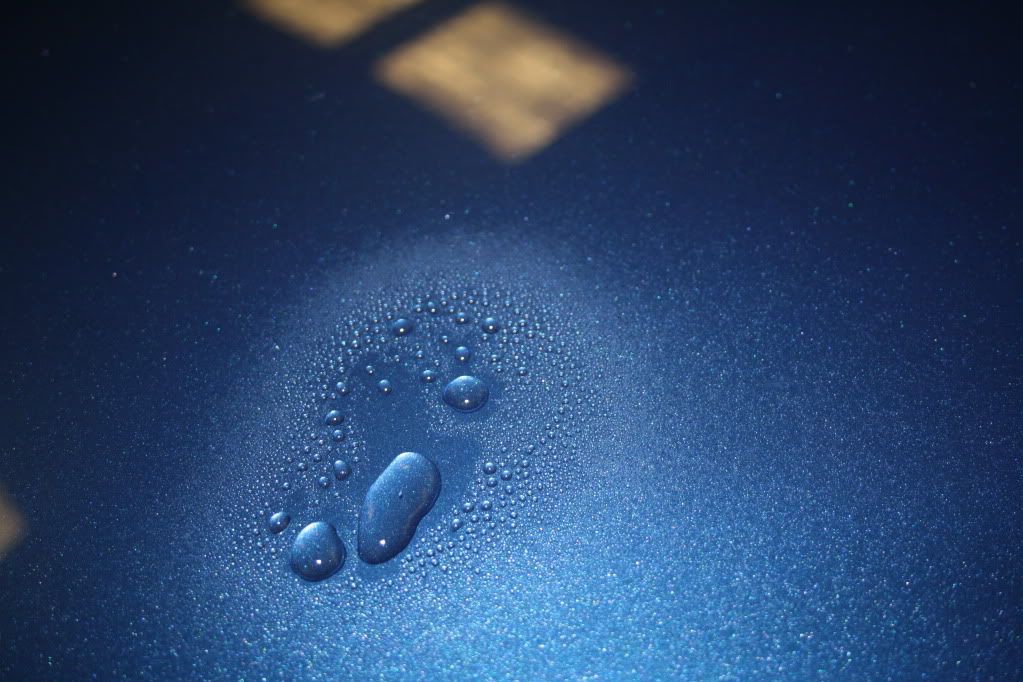

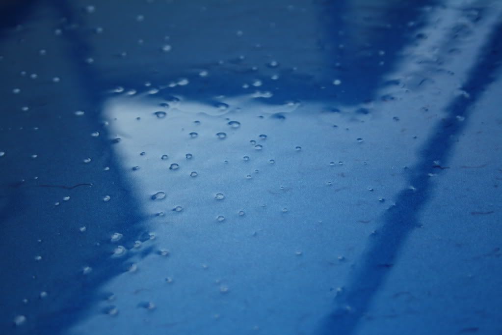

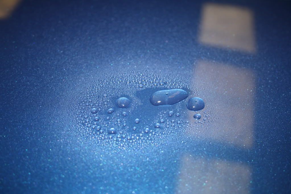

    After this I cleaned the glass and gave them all 2 coats of Autobrite repel and also gave the arches another coat of hyper dressing

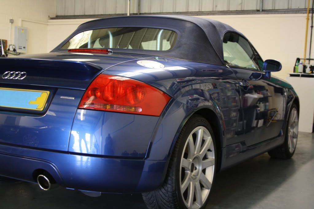

    The car was taken outside for a couple of shots
    A couple of beading shots
    And a couple of my favourites lol
