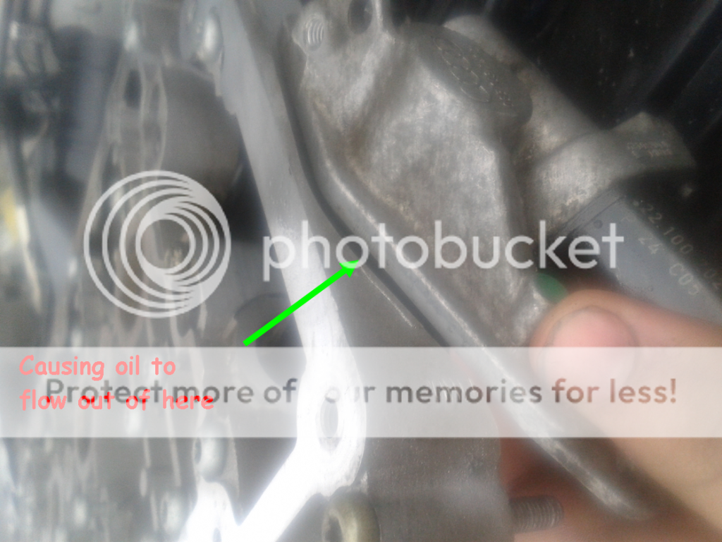

    So, the car now runs and drives, much to my amazement! But its losing oil quick time. I can see it coming from the exhaust front cam seal, and its dripping like mad out of the solenoid that controls the VVT (i think thats what it is) onto the coolant flange at the back of the head.

    Right, think ive figured something out. The from cam seal shouldn't be a problem, just means taking belt off AGAIN. But i can do this in about 20 seconds, left handed and with my eyes closed now lol.

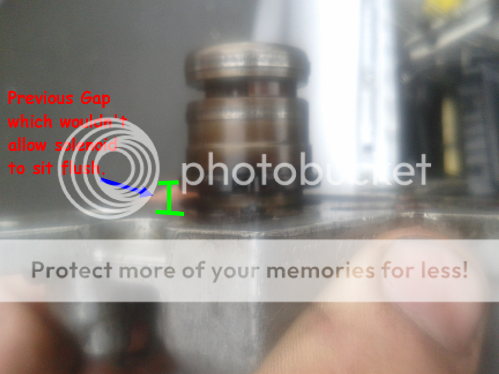

    Anyway, as for the rear, the solenoid isn't meeting the head flush? there is about 3mm difference, ive taken the cam frame off and lined it up, and it seems the VVT solenoid needs to be squeezed back together or something?? Ill Post up a picture to try and clear things up

    Ok, so with a spare solenoid, i got a G Clamp and compressed the shaft so that it will now seat flush. But my question is, how do you remove the one on the inlet shaft? I given it a wiggle and a pull, but can't pull it free? Anyone done one of these before?

    You need a VW compressing tool T10092 (basically a bolt and nut!) to compress the tensioner and possibly the frame is misaligned due to you not using the T40029 alignment pin for the frame.

    Should really of read his before i worked on it earlier lol. Didn't bother using the tensioner tool, i just loosened the frame off and let the cams pop it off. Left the chain on and the tensioner pushed up against the chain. Then, i just tightened the frame back down and maneuvered the cams back into place. The tensioner then resumed its normal position.
