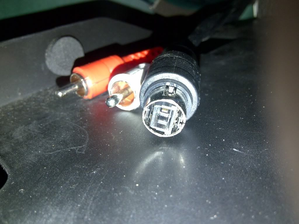

    We have now noticed that there is a second set of connections tie wrapped to the CD changer lead in the boot. See images:-
    So basically I have two questions.
    1) Does anyone have any ideas how to get the head unit to recognise the Changer?
    2) Does anyone know what the extra connectors are for (RCA in / RCA out, what is the third one?

    In relation to question 2:
    These are 100% after market cables... Possibly the previous owner had an after market kit installed... I know most people tend to leave the cables in as it is too much hassle taking them out
