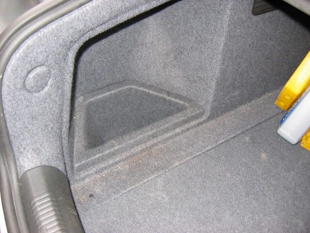

    If you have a lead pre-run in your boot it should have a round connector on it. (but check first to make sure)
    If you haven't got the lead there already buy either (the VW or Audi lead) and the matching changer. Either will work.

    I've looked into my boot and tried to take the liner out on the left hand side.....'tried' is the key word!
    I presume that if there is a lead already fitted in it'll be under this liner, but I can't get it out.....it seams to be clipped in three places, but I've no idea. Any ideas?
    I've posted a pic of the liner I'm talking about.
