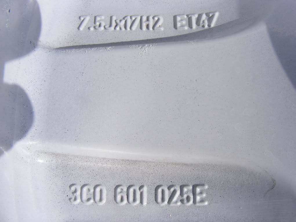

    Hi all
    as above just wondering what the offset is above for the Monte Carlo Wheels on my Passat B6 Sport? Cant get the wheel off at the moment but would not mind trying to find OEM or replica VW wheels, Maybe 18" but with a better offset to give a more aggresive stance... and not keen on spacers due to disatorous problems with balancing on my previous A4.
    I had 18" Audi A4 5 spokes on my audi with an offset of ET42, With 10 mm spacers it looks the dogs, but with weight in the back they scrubbed.
    Hope you can help

    Here you go:
    07 Passat SEL Sport TDI 170 R
    Deep Pearl Black

    Don't go more than et35 and you should be fine. Spacers can be a pain. Up to 5mm and more than 16mm means you should be ok cause the rim should still be sitting on the hub or the extended hub of the spacer. I have custom 8mm Spacers on mine and she's silky smooth, but only cause the wheel is tight on the centre hub.
