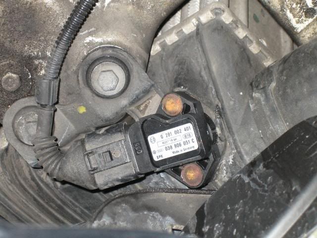

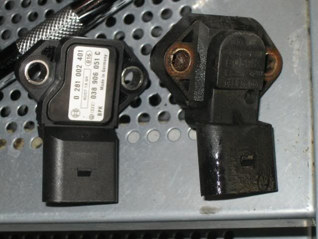

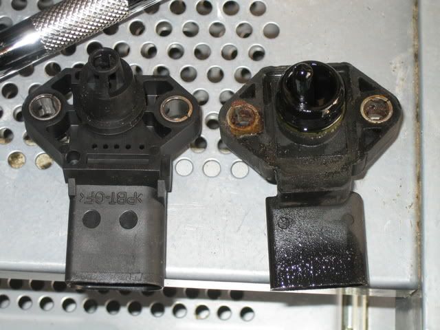

    UPDATE 3 JAN 2009 CHANGED MAP SENSOR TO 3 BAR AND THIS HAS SOLVED LIMP MODE PROBLEM! ALL IS FINE NOW!! ONLY TOOK 2 YEARS THO LOL
    UPDATE 01 NOV 2012 ALL STILL GOING WELL
