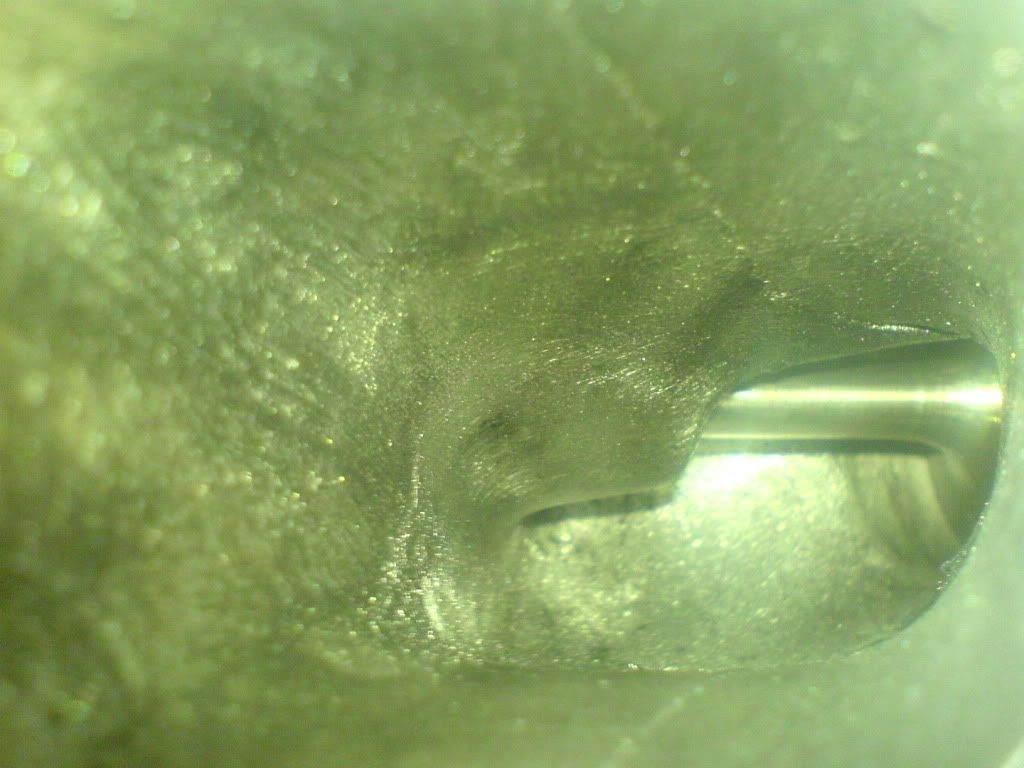

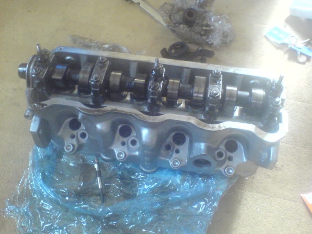

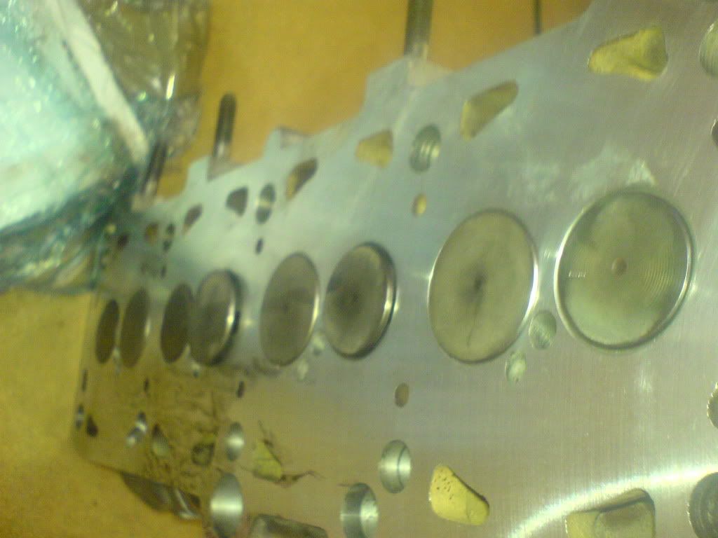

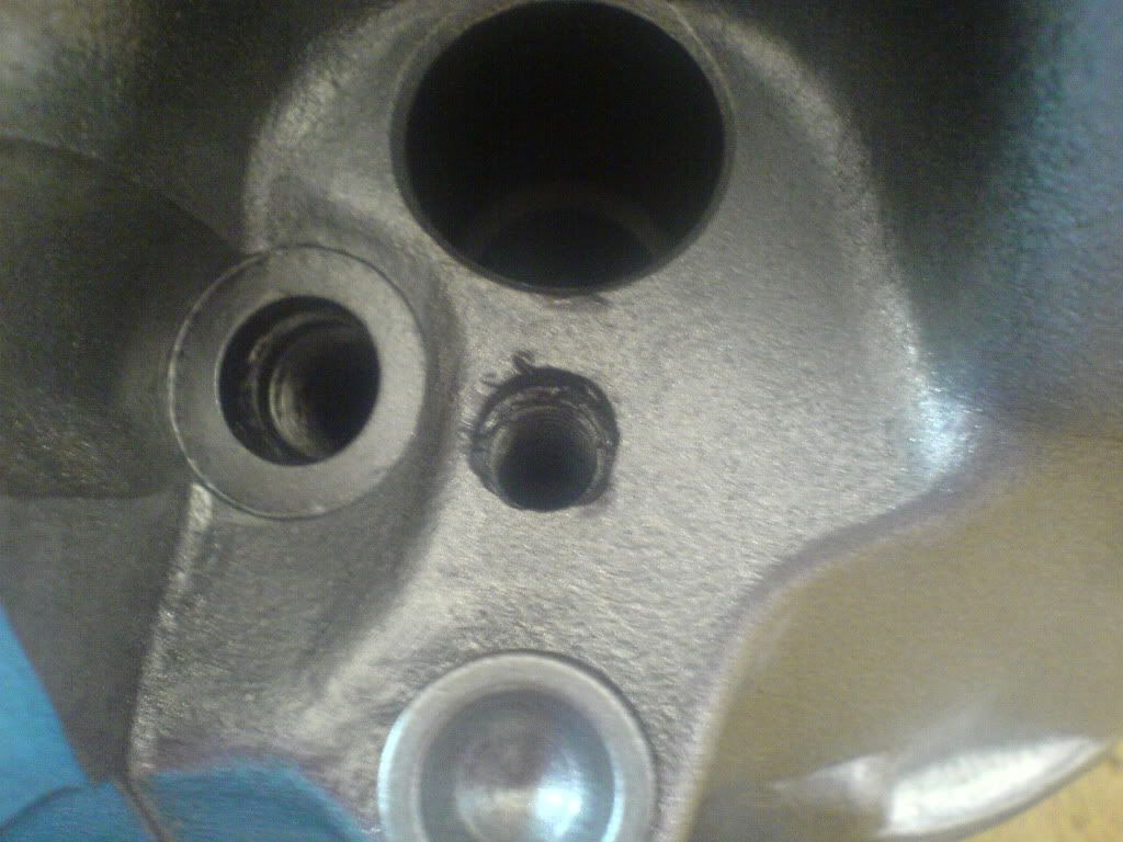

    Look what a UPS man just delivered.......
    One shiny cylinder head!
    The removed bolt!
    Inside the intake port
    Inside the exhaust port
    The valves and cleaned bottom
    List of what was done!
    I am very pleased, and they saved me a job by painting it silver for me already. Might get some high temp clear lacquer just to keep the shine!
    Need to fit it now and then get the timing done by a garage. But, unfortunately, i dont think i have enough money for it until the 27th. Bit of a bummer really!
    Enjoy the pics!
    Rich
