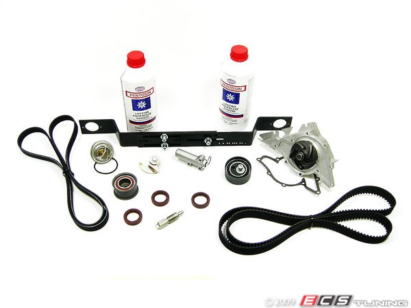

    We have timing belt kits available below.
    Click HERE to order or for more information.
    Let me know if you have any questions.
