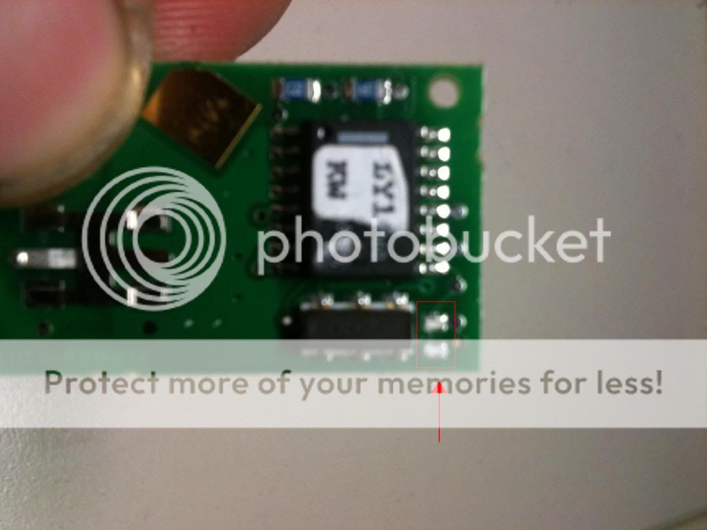

    i have swapped the casing on my damaged fob (1999.5 A4 avant TDi) and in doing so, i have broken off one of the SMD Resistors / Capacitors, It's located on the battery terminal side of the circuit board (see attached image)
    Can anyone give me a number off theirs so i can aquire and solder a replacement on?

    cany anyone pop their remote fob apart and tell me whast on theirs? 2sec job

    All sorted. its a 103
