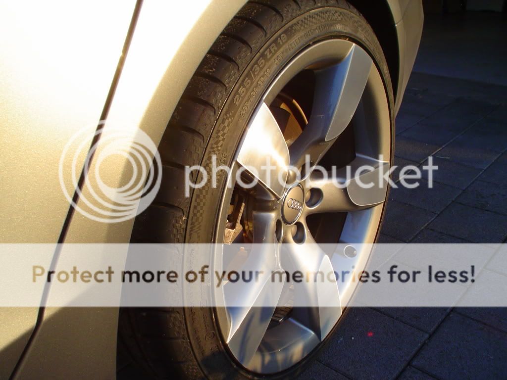

    I fitted some A5 19 inch ET35 9J wheels to my A4 B8 with 255/35 tyres, they fitted but would not get through the German Equvelant of the MOT(Tüv) and they were only slightly stretched and were a nightmare when it came to parking because the rims are exposed!

    Stretched tyres either you like them or not, you can achieve a better result using a good ET with the correct tyre, it just looses you "PUB TRUMPS" point scoring cause you can not whip the saxos 8J Rims .
