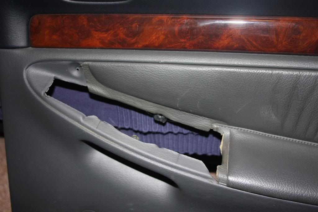

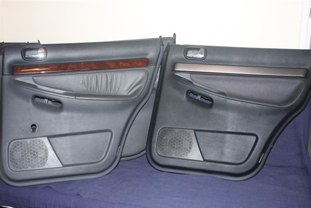

    Since my door cards are manual and the electric door cards are black, I had to swap handle section over where the switches. Not a hard job just a bit of a pain really.
    The two door cards side by side.
    The rear plastic sections that i'm swapping over.

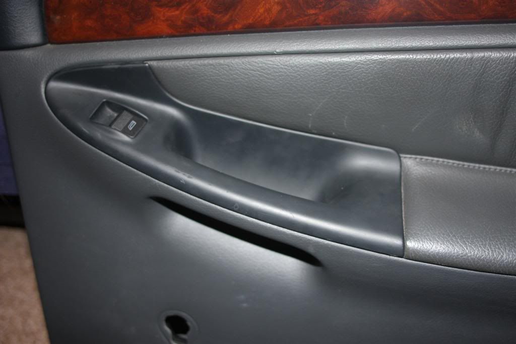

    The parts removed from the door cards.

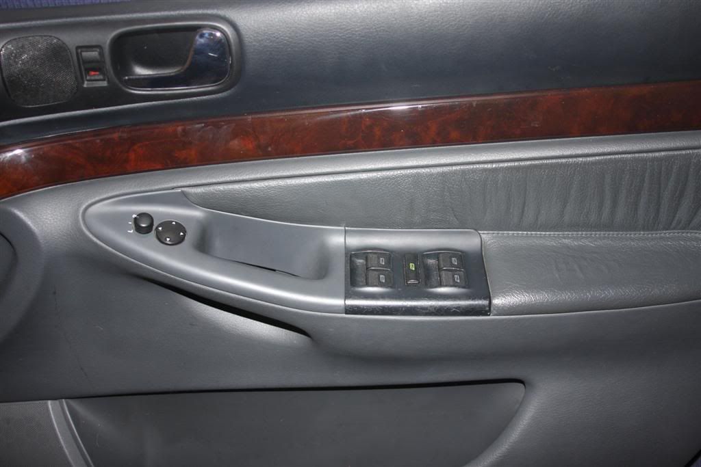

    Electric switches fitted to my manual door cards.
    Also added the 5 switch pod to the drivers door.
    Now i can crack on with the loom.
