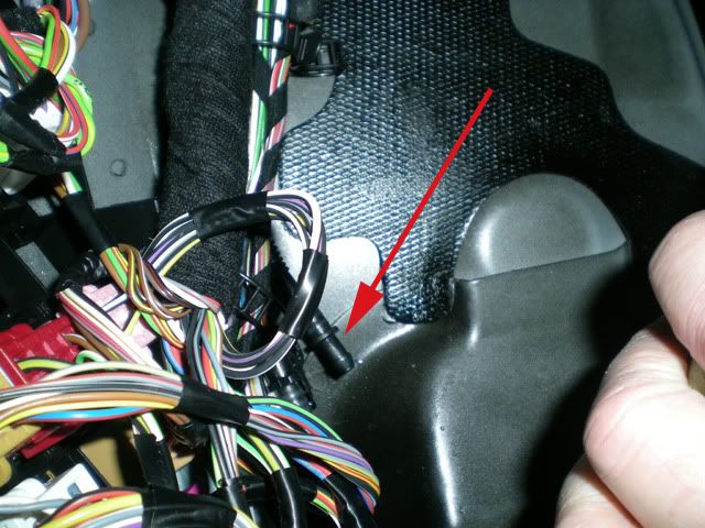

Same issue with mine, Haggag01.
The disconnection in the rear cubby hole had prevented the washer from working, but there was also a partial disconnection behind the A pillar.....
http://img.photobucket.com/albums/v2...ics/WIFW1B.jpg
The rear washer was still working, but it was draining back down through the leaking joint and flooding the floor underneath the carpets, which was causing a delay in the operation of the washer jet. The water was only apparent in the rear footwell, but it was underneath the carpets in the front....

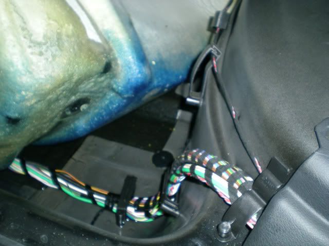

http://img.photobucket.com/albums/v2...ics/WIFW1a.jpg

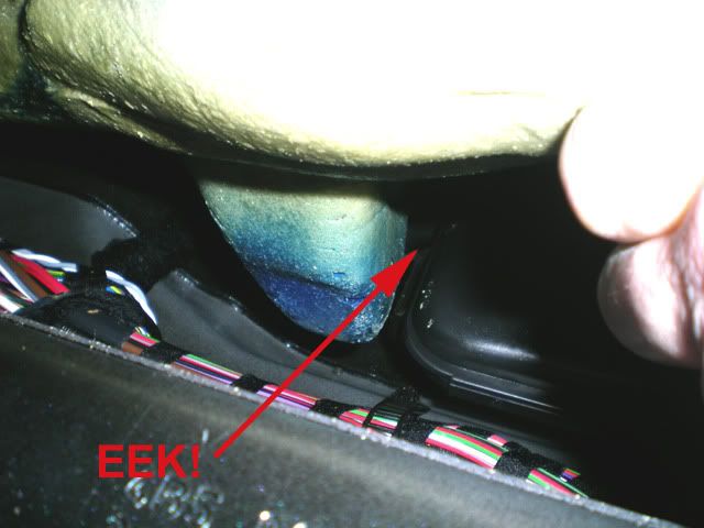

Not the wisest site for an electronic control box.:confused:......
http://img.photobucket.com/albums/v2...ics/WIFW1C.jpg
Those rear seat benches need a proper good tug to lift them out!:bigeyes:
