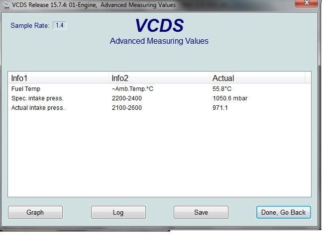

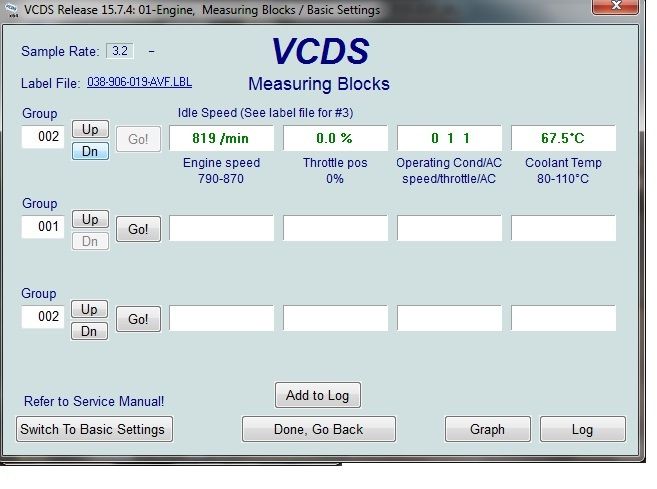

The first display is of Measuring Block 011 but you need to show the figures for zones 2 and 3 in 3rd gear at 3000 rpm approx or do a screen grab of 011 in graph form.
http://i222.photobucket.com/albums/d...boostgraph.jpg
