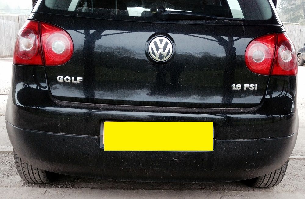

Does anyone have a photo of the Westfalia Fixed Swan neck P/N 321811600001 that doesn't require any bumper cuts.
I'm concerned that there's no enough clearance - if anyone has a specific photo for the mk5 that' be great thanks. Photo of why im concerned really doesn't look like enough room!
