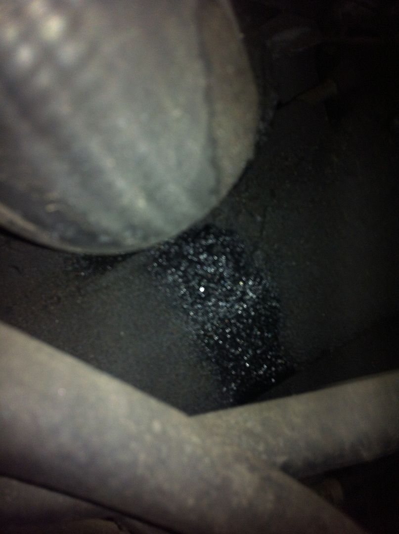

was driving, then the it just reved high for a few secs and died.. smoke everywhere and some soot on the road... it started but not as quick and drives like its in limp mode all the time

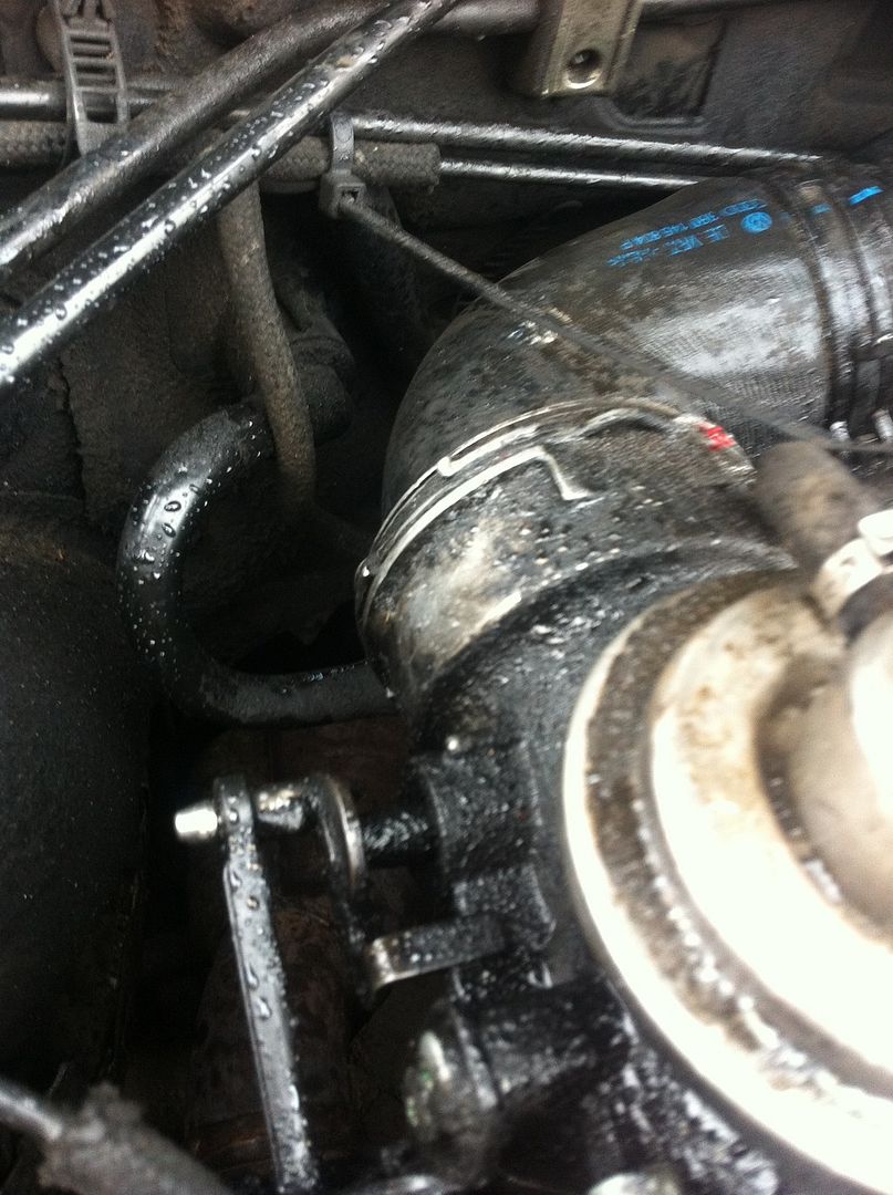

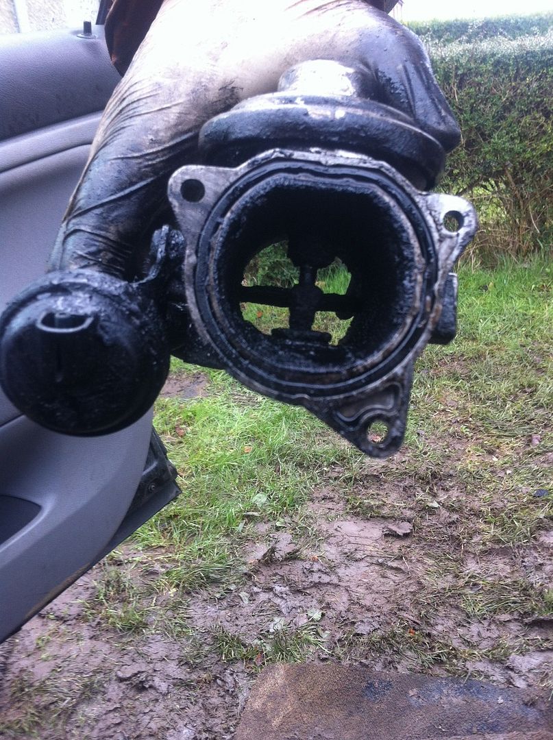

Bloody seek, spent ages today checking the pipes, 12v to the n75 then cleaning the asv as there was loads of oily crap, the butter fly flap didn't fully close..

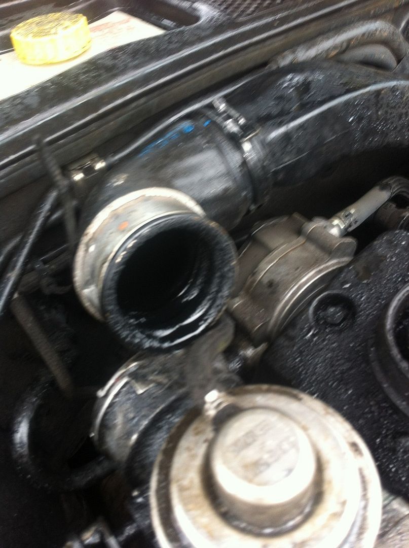

Next on the list was the pipe that connects to the intercooler, even though it has the metal clip it opens alittle when moving it. Noticed after the high revs etc oil dripping from it#

can see the oil been running from the intercooler pipe

whats the chances of engine being ******? not sure if it was classed as a runaway, was close..

Hey Joe (...good track that Mr Hendrix), that's all normal ****, you ain't showing me, Zolly or anyone else some filth and gunge we aren't up to our testicles in every working day. The upset your engine went through is because the turbo over sped because it is out of control, how about doing the job properly before throwing cash at it! Anyway, you can get your turbo rebuilt for £250 as long as you over speeding the poor sodding thing has't FUBARED it!
