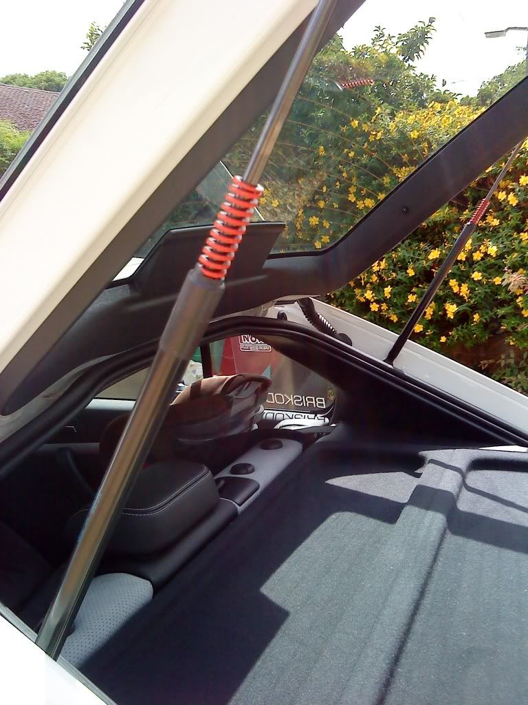

    for those people who have newer cars I guess, that have a boot open button on the keyfob. My 2007 A3 had one for example.
    This is a great mod for the A3, Golf, jetta/bora etc etc
    Righty, the Red springs arrived today from BearingBoy's - item 31135
    tools I used:
    small screwdriver to take the clips off
    pliers
    workbench to clamp the pliers tight around the strut
    drill screwdriver bit holder - was a snug fit to turn the ends off
    Tape - for now it's black taped.

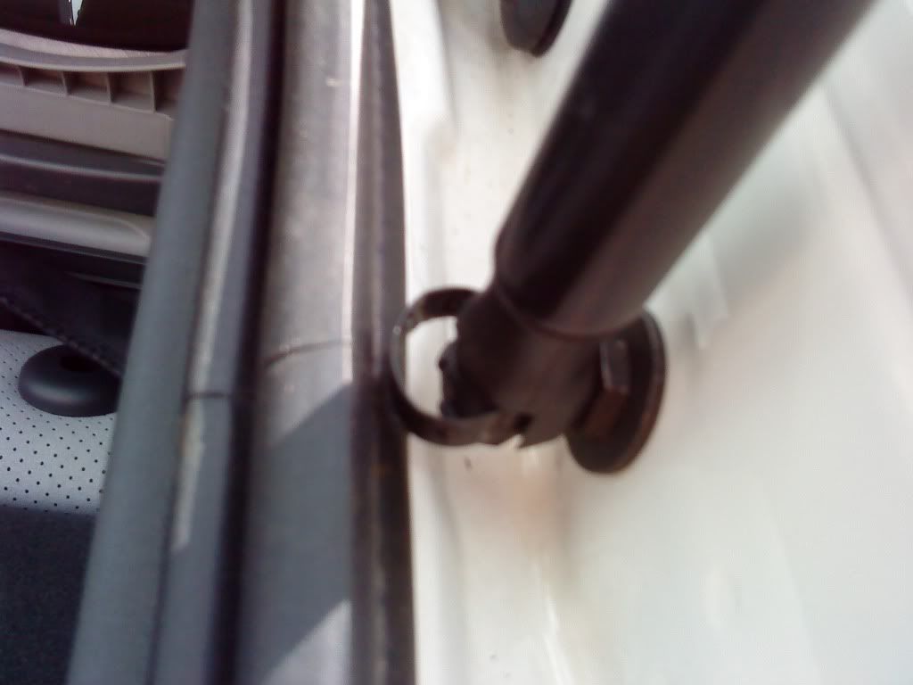

    Top Tip:
    Do NOT fling the clips all the way off - they are fiddly to get back on. but if you do then just offer them up to the end of the dtrutt and slide on(you'll see two grooves) by not sliding all the way off the struts go back on super fast.
    Note:
    the tailgate either has to be closed or resting shut when only one side is on as it's far too heavy. when putting back on support with your head to get the bottom of the strut on first.
    Piccies:
    only unclip to here:
    both in place:
    resting on itself:
    Video of operation:
    They work great, I've had a look at the compression when the bootlid is almost shut and its millimetre perfect. £10 well spent IMO.

    Seems the compression of the spring was too much. Have taken off these springs and have ordered some stronger but a lot shorter so that the compression is correct.
