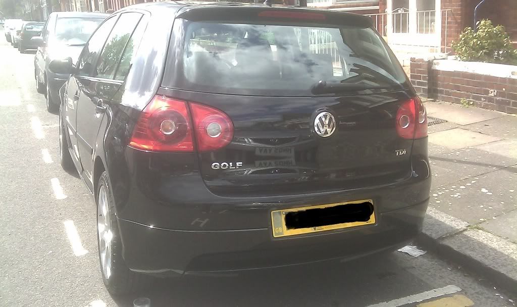

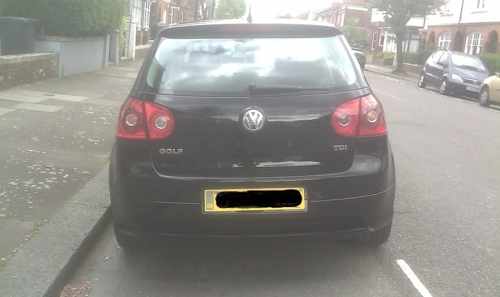

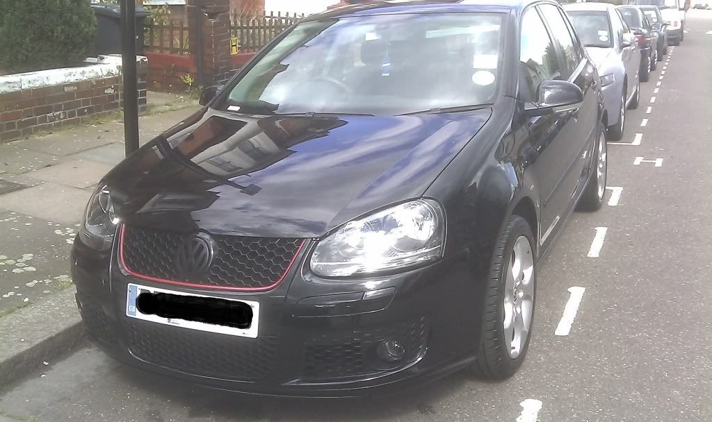

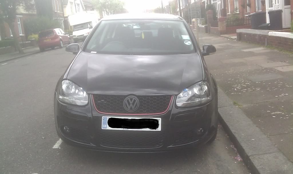

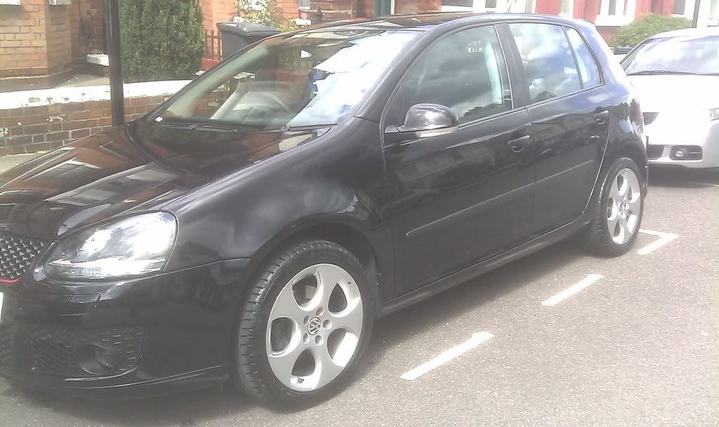

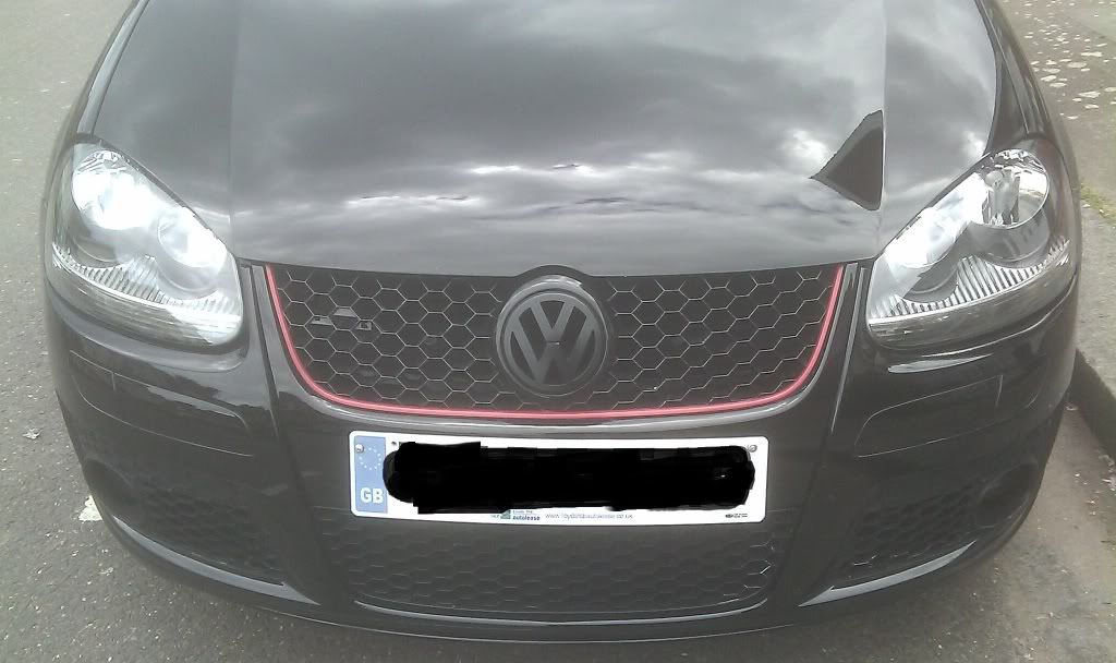

    I managed to plough on, after waiting 2 days after the initial claying of my car I had rain spots all over it so i basically gave each panel a quick spray of water and wiped it off so i could begin with the swirl x on each panel.
    After applying the swirl x it seemed more to polish the car as it was shining afterwards especially in regards to the AG SRP when applied it was very runny and dried up very quickly especially with the polishing cloth but nevertheless i applied it all over the car and to be honest to my untrained eye it didn't add to much of a shine compared to what the swirlx did after claying
    I presume maybe one or the other is required depending if you want to fill in swirls or just polish.
    After all that (believe me sounds short when writing) I applied the collinite very easy wax to use and I hope it beads the rain (secretly wanting it to rain so i can see lol)
    Basically this was my first time ever using these products, and as a quick tip anyone using the megs clay kit go easy on the lubrication spray lol we've been advised to use it generously so that the clay is not applied on a dry panel but i guess i got a bit trigger happy.
    Also break a little clay of when claying the side panels etc i'm glad i did, because after claying the roof I was adamant I wouldn't drop the clay on the ground (if you drop it on the roof doens't matter its not going to fall to the ground) but the first thing i did when starting the side - you guessed it dropped the clay
    Sorry for the rant here are some pics of after the clay: and then after the polish - can't see much difference lol crappy phone camera but there is
    After claying
    (Had to stop at the above picture it started raining) After swirlx, polish and wax ~ 2 days later
