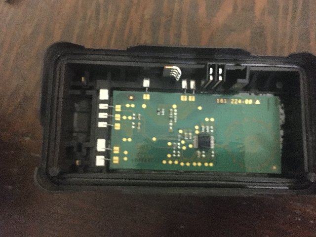

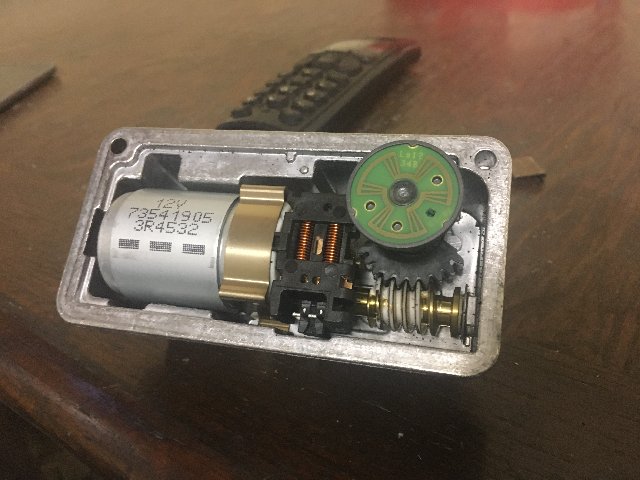

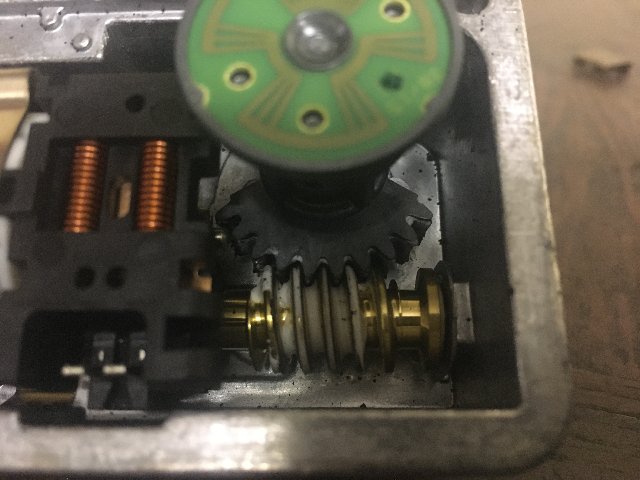

    FIXED!
    No £6K at the Audi dealer or DIY £3.5K+ for a new turbo unit.
    £182 all-in, for an allegedly "100% new old stock actuator".
    For reference:
    The actuator that came off was visibly fine and it even wound itself back to its default/fail position after being manually forced to open.
    There were no broken gears inside the actuator and the electric motor was working.
    Presumably the actuator had developed an 'electronic' fault on its board.
    The replacement Hella actuator was plug 'n' play (no calibration required) and the car drives perfectly again with no fault codes registering.
