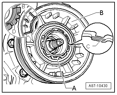

    Detaching/attaching pulley
    Detaching
    Remove the sealing cap -A-.
    Hold the air conditioner compressor drive shaft -B- with a commercially available hexagon socket wrench (7 mm) for example and turn the drive plate -C- with the pulley -E- in arrow direction -arrow-.
    Note
    The torque for driving the air conditioner compressor is applied to the compressor shaft by way of the bolted joint of the drive plate -C-. If in the course of air conditioner compressor operation the drive plate -C- has become so firmly attached to the compressor shaft that it can no longer be unfastened (the 7 mm hexagon socket wrench -B- can no longer transmit the necessary torque), the air conditioner compressor must be replaced.
    Detach the drive plate -C-.
    Remove the circlip -A-.
    Detach the pulley -B-.
    Attaching
    Note
    Replace the circlip -A-.
    Clean the flange of the air conditioner compressor before fitting the pulley -B-.
    On fitting the circlip -A-, take care not to bend it open more than necessary for installation.
    Fit the pulley -B-.
    Ensure correct insertion of the circlip -A-. The bevelled side -C- faces away from the air conditioner compressor (flat side faces compressor).
    Clean the thread of the compressor shaft.
    Note
    The thread of the new drive plate is pre-greased at the factory with a pre-determined quantity of a specific grease.
    For fitting the drive plate, coat the rubber elements -D- slightly with tyre assembly paste or soap solution for example to provide lubrication.
    Insert the rubber elements -D- in the pulley -B- as shown.
    Press the rubber element of the drive plate -C- into the pulley -E- until the drive plate -C- makes contact with the thread of the shaft of the air conditioner compressor -B-.
    By turning in the direction opposite to the arrow -arrow-, screw the drive plate -C- onto the compressor shaft -B-.
    Hold the air conditioner compressor drive shaft -B- with a commercially available hexagon socket wrench (7 mm) for example and secure the drive plate -C- with the pulley -E- by turning in the direction opposite to the arrow -arrow- (tightening torque 30 Nm).
