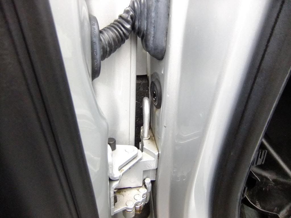

    1. Drain all four corners in sunroof, front one are cleaned by insertion of tool from top to bottom, rear are cleaned by inserting tool from bottom to top, front drain end is located between lower & upper hinge in door on body, rear drain end is located behind rear wheel liner on front section of arch.

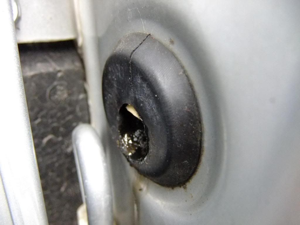

    Can you see the end of drain tube in grommet?

    Thanks - the drain is now clear-ish. I can blow through it and water flows but I still can't pass the cable. I definitely want to remove the trim to see if there is an issue with the pipe itself. There is some sort of sharp bend about 30cm up from the outlet that I can't get past on the drivers side. Passenger side is similar but cable passes with just a bit of pressure.

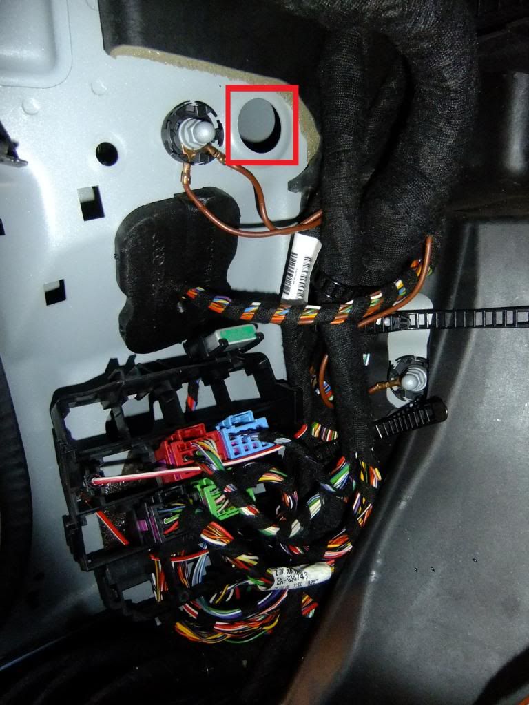

    So you wanna remove A pillar trim? the one between dash & roof trim ...
    Is A pillar trim showing signs of wetness?
    If you remove the lower door trim like you asked in PM you can only access pipe through the hole in red box ...

    Couldn't help noticing you've not been as particular as me by greasing the door hinge wheels from he pic above :-) I went mad and greased everything including the battery terminals So guaranteed no rust ever gets a foothold.. anywhere!

    Quote Originally Posted by bloostar View Post
    That photo is few months old, they started squeaking at some point and then they were done with plastilube ...

    Quote Originally Posted by gupsterg View Post
    No sign of wetness thank goodness. I just want to see what the shape of the pipe is about 30cm in and work out why I can't pass the cable. There's definitely some sort of bend about that point. I tried to pry off the trim but lost my nerve. I really hate removing trim as the little clips usually snap!
