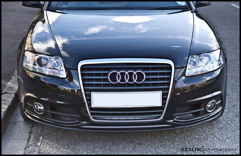

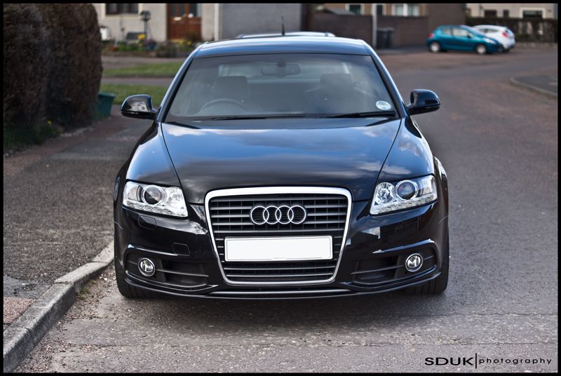

    So the RS6 splitter I had ordered came today and my friend and I set about fitting it tonight
    This was the front before...
    and here it is fitted...
    Really happy with it, subtle but OEM
    Very easy to fit and I love it!
    Part number is 4F0807110A 1RR and itsshould be over £100 from Audi but cheaper from this eBay seller...
    NEW GENUINE AUDI RS6 C6 FRONT LOWER BUMPER SPOILER TRIM - 4F0 807 110 A 1RR | eBay
    Spoiler should be here from Taiwan soon
    It was hard to capture the splitter in the photos but tried my best!

    Very nice, did you paint it or is that its original finish, hard to tell from the photos?

    That's the standard colour and finish

    Looks great, anything else needed for fitting?

    Thanks for ease of fitting we drilled a few small pilot holes along the curve of the splitter then used self tapping screws to attach it. Started in the middle then worked my way out to either side also had to trim the two "legs" on the spitter so it sat flush
