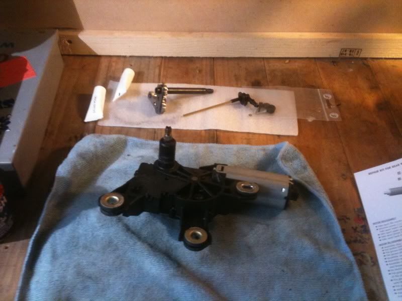

    I've just resolved soggy carpet/boot issues on my 167k 2001 a6 1.9tdi avant with that i bought last month.
    There was a small amount of water sloshing around in the front and rear n/s footwells, on boot floor, inside tailgate and in cubby hole in boot under toolkit.
    Sorry not many pics but I'll describe what I did.
    Thought some preventative medicine was in order also so I just tackled all the known problem areas as I plan to keep this car long term.
    It was definitely leaking from the pollen filter housing (both from the base and from water dripping onto the filter directly off windscreen due to badly fitted plastic cowl thingy at bottom of screen),
    also the tube to rear wash/wipe was leaking from all 3 usual places where there are joins plus it had invented a new few new places to split and leak (inside c pillar and out of wiper motor housing in tailgate). There was a previous fix in the bung between tailgate and roof on o/s- a piece of heavy rubber tube in lace of the plastic tube where it had split due to opening/closing tailgate.
    Tackling the wash/wipe I first rebuilt the wiper motor with the kit from audi-
    This replaces the tube within the wiper spindle that leads to the washer jet and the jet itself, my old one had disintegrated and the jet had disappeared.
    Then I traced the tube all the way from the rear wiper to the front bulkhead- It was leaking in the n/s c pillar, in the boot cubby hole (above toolkit), in the rear footwell and at the front bulkhead, I super-glued the bits where it was leaking from joins and where it had split I cut the pipe and used 8 inch lengths of hose to join it again.
    I noted that someone had previously ripped (literally) a section of carpet from the n/s rear footwell and jammed an ill-fitting piece of copper pipe in the tube where it had previously split. This rubbish fix was leaking profusely. They had also covered the bare floor there with several filthy, worn, dog-hair-matted bits of old tesco value floormatt.
    Rather than bother taking the entire carpet out to gain access to the front footwell I just cut it under where the matt sits since I didn't have a full carpet anyhow. I left this section drying next to the boiler in the house for a week as it was soaking.
    I also drilled a new 15mm drain hole just in front of the front passenger seat with a new rubber plug that can be removed if there's a leak in future.
    Also, before starting all this I treated the screen wash bottle to some sterilising fluid (miltons), as I didn't fancy legionnaires disease or getting sprayed with any other minging bacteria.
    Pic of front n/s footwell with the expensive CCM (comfort control module or convenience control unit or whatever) housing that doesn't want to get wet-
    I unplugged this and checked it out- it wasn't wet but some wiring had been replaced (and poss the ccm itself) in the past so it had been submerged in water before.
