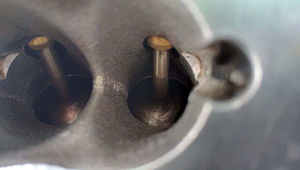

- Picks! You'll want little picks of different styles. You will not get all of the carbon desposits from the valves/ports without them, no matter how hard you try. I started by scratching the dry carbon gunk off with a flat screwdriver, and blasting the bits out with an air duster, making sure to catch it in a towel. Make sure the valves you're working on are closed, and that all others are block with rags. Also, make sure the injector holes (if they come out with the IM - all 4 did for me!) are blocked - you really don't want this crud dropping into the chambers!
- Seafoam... Totally overrated IMO. I found Wynn's Carb and Injector Cleaner to work much better. Once the main chunks of carbon were picked off with a flatblade and picks, I flooded the ports with carb cleaner and let it sit for 10 mins or so. With the carb cleaner still in, I attacked it again with picks and a brass bottle brush by hand before extracting the fluid/gunk with a hand pump. I put more carb cleaner in then attacked it with fresh brass brush in a drill. Sounds very harsh, but it'd be very difficult to do damage in here - just don't do anything stupid or jam things in hard and you'll be fine. Once the thick stuff is off, it cleans up surprisingly well (see photos).

Dirty, gunky valves:
http://img.photobucket.com/albums/v1...416_154056.jpg
http://img.photobucket.com/albums/v1...416_154046.jpg
Clean valves:
http://img.photobucket.com/albums/v1...418_114321.jpg
http://img.photobucket.com/albums/v1...418_131555.jpg

Amazing work, how you turned those dirty valves brand new is great.
